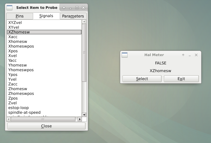

Hello -
I am setting up a new 7i76e to replace my 10-year old 5i20 setup and need some assistance
I used PNCCONF to generate the configuration and assigned input pins for Axis Select and Jog Increments because I wanted to use a simple 4 position rotary switch to select the axis and jog increments, I don't want to use an MPG to do this because I already have a USB Jog pendant (XHC-HB04) and don't need any additional MPGs.
When I send a signal to the pin in question either using GND or FIELD VOLTAGE the pin does not change value TRUE/FALSE. I am hoping its a simple case of not knowing how to wire a rotary switch correctly to the pin in question.
I am using AXIS for display but I am not opposed to switching to some other GUI to get this to work.
Any thoughts ? Thanks.
-ali

Just to be sure, the physical pin 1 on the 7i76 header is pin 00 in hal, and so on.

Hi -
Its a 7i76e, and I am watching the Signal from Hal meter so I don't think the pin numbering is significant.
Here is an example screenshot from a Virtual Machine, since I am not near the real system.
-ali
-ali

Right, but that signal has to be wired to some pin in hal, since you are sending the voltage/signal to a pin.
So first check if the pin is changing state, at least that would point to the issue in hal, not in hardware and wiring.
