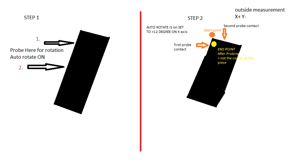

I seem to have something strange.
1. When the probe is finished doing a probe routine and remain in the probe screen tab ( axis gui). and i press 9 on my keyboard. My z axis doesnt move just a little, it moves all the way to max Z. When i press 8 or 2, the machine starts to move to i don't know where, i haven't tested this till where, it scared the shit out of me. Same for 4 and 6 for X axis
Is this normal?
2. Secondly, after doing a probe routine my XHC pendant no longer works until i went out of the probe screen and used the keyboard to move my axis a little, than the pendant will work again. Any solution to this? It is extremely annoying cause after finishing the probing, i actually have to walk to the screen to change the tab and move the machine so i can go back to the workpiece and move with the pendant to the desired position.
3. Thirdly, if i have it correctly, if a workpiece is under a rotation, i first have to do the rotation routine and than the 0 points probing routines should be working in the changed coordinate system ( if ofcourse the system is set to auto rotate). Does this act the same in Version 1 of the probe screen. Or is this only in version 2? Cause i had the impression that after the rotation, my probing was still working in X and Y directions without any changes. I am working in version 1
4. Is the update to version 2 an easy thing to do?
Thanks for any help

01 Jun 2020 12:18 #169689
by Marcodi
Replied by Marcodi on topic Probe Screen behaviour and questions. Based on the probe screen by Vers.by
So i have been testing both version 1 and version 2 of the probe screen. The readme clearly states that when autorotate is in effect, all other measurements will be done in the new coordinate system. This is the result i got. It clearly is not working as it should. Anybody and idea or faced the same problem?

02 Jun 2020 16:52 #169873
by Marcodi
Seems nobody is using this probe screen
Are there other good probe options available. That do rotation and than set an XY 0 point taken into consideration the rotation?
