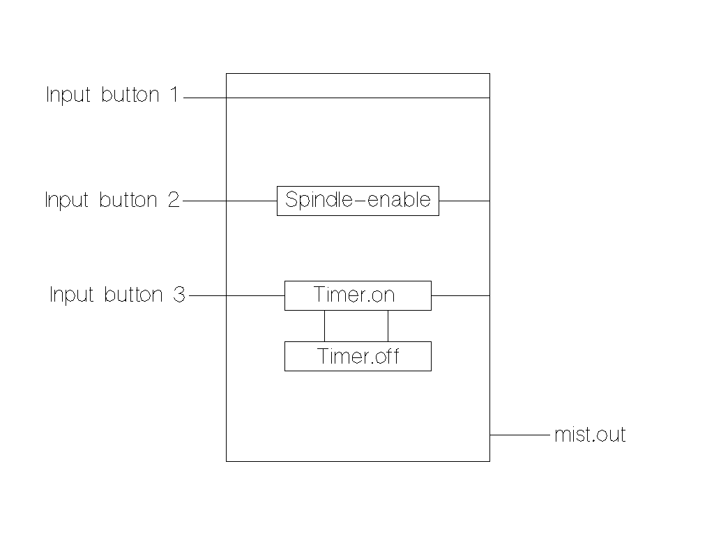

I would like to write a module for a mist extraction system that can also be used for interval control. At the moment I'm still helping myself with a shell script. But I would like to implement it. Unfortunately I couldn't find any examples of a linuxcnc module and my knowledge of C is minimal. Maybe someone can help.
The module must have 3 inputs.
Button 1 on -> output true
Button 2 on -> variable (spindel.enable) -> output true
Button 3 on -> variable (timer.off) -> output false
Variable (timer.on) -> output true
all buttons off -> output false

yes thanks the first two bits are easy too. The problem is to create an interval with timedelay. I failed of it. The third button should switch the output true, for example 30s, then wait 5 minutes and then switch it on again for 30s.
My shell script looks like this.
halcmd unlinkp hm2_7i76e.0.7i76.0.0.output-01
while true
do
halcmd setp hm2_7i76e.0.7i76.0.0.output-01 1
sleep 30
halcmd setp hm2_7i76e.0.7i76.0.0.output-01 0
sleep 300
done
exit 0

my first draft full of bugs. but i'm a mechanic. I hope you can see what I want.
Warning: Spoiler!
component mist "3 way input mist modul";
pin in bit in0 "Manual mist on";
pin in bit in1 "mist on if Programm run";
pin in bit in2 "mist intervall on if Programm run";
pin in bit in3 "On Timer default 30s" ;
pin in bit in4 "Off Timer default 300s";
pin out bit out0;
function _;
description """
Modul with 3 Input and possibility of interval out
1. input.0 true -> output true
2. input.1 true -> Variable halui.program.run true -> output true
2. input.2 true -> timer.0 true && timer.1 false -> output true""";

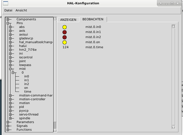

For my first lesson not so bad. Modul is working and timer is one include? May i can count them
with original timer example i got error
mist.comp: In function ‘_’:
mist.comp:71:12: error: invalid storage class for function ‘__comp_get_data_size’
mist.comp:71:1: error: expected declaration or statement at end of input
mist.comp: At top level:
mist.c:45:12: warning: ‘__comp_get_data_size’ used but never defined
static int __comp_get_data_size(void);

I think in your first example you had a data type error becasue you had a bit as the input pin (which can only be 0 or 1) and you were using it to set it to 300. That likely explains the error messages.
