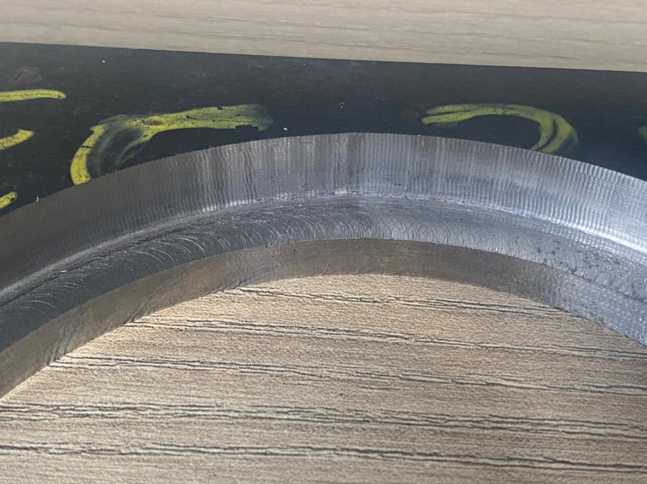

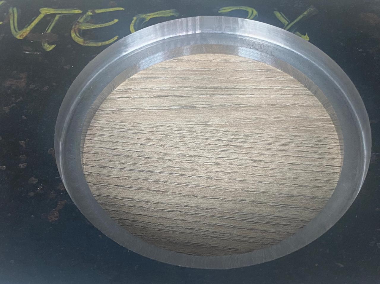

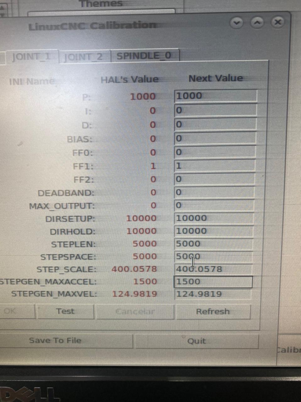

Hello Guys, I'm working on a retroffiting with linuxcnc version 2.9 and 7i76E. Drives and servo motor (Chinese), the machine is making contours all perfect dimensions, but I'm pretty crazy because the interpolation is vibrating (leaving the axle just after reversing the axes) in the 4 corners, very symmetrical, only more on the Y axis (+ and -). I sent the images of the piece to see and understand better. The last image in calibration, where I changed the PID values (without positive results), I changed the FF’s (I didn’t accept the change, as soon as it changed, there was an error on the machine), I changed all without good results. The step_scale was the first one that I adjusted the dimensional part and it was great. Ah, I also used the codes G’s, G61, G61.1. (the machine was shaking all over), I used the G64 P0.01, G64 Q0.01 (it didn't get better or worse ...). Guys I'm very lost if someone can show a light thank you very much.

Looks like backlash. They are worse at the reversal points.

OK the hal/ini files look OK so I would expect the error is not in step generation

i guess pretty sure it's a tuning problem. But without to know which hardware did you use its hard to say, a useful answer. First step could be try to set the P value to 5 or 10 and see what happens. Another idea would be put a pencil in spindle and write the circle on paper. So you can see wath do machine without load.
