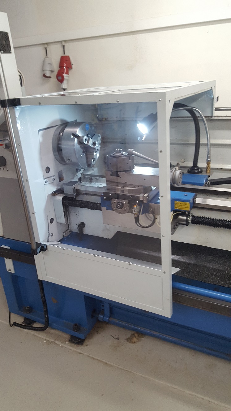

Jaro, I would love to see some pictures of your machine and conversion.
Mark
Mark
