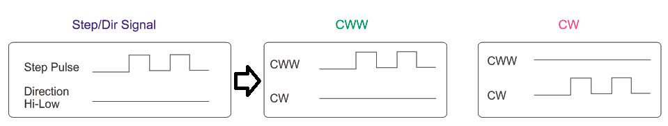

I'm not feeling confident that I understand the details of counter mode from the man page which says:
One can understand quadrature to be the same as step/dir for the most part - we get the same number of counts - up-and down. (The other phase will correctly set direction). I think there are other things that change with this setting?
Set to False (the default) for Quadrature. Set to True for Step/Dir (in which case Step is on the A pin and Dir is on the B pin).

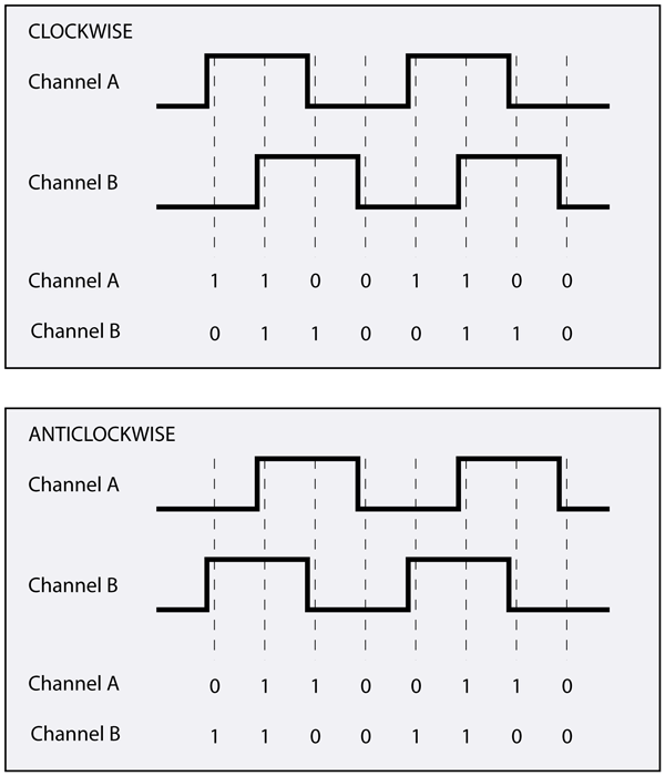

Counter mode 0 is quadrature and uses A and B signals shifted
by 90 degrees. Almost all encoders work this way. Quadrature
has the advantage that every edge is counted and the count rate is
4X the actual frequency of the A,B signals.
Counter mode 1 is step/dir or up/down counter mode where
every rising edge of A is counted, and the direction of the count
depends on the state of the B input at the A rising edge.

It is not the above that confused me - it seems something else get changed at the same time? - Is it the way index works?
If I set counter mode true - count increases as the spindle rotates - if I set if false - count no longer increments (along with position and raw counts ). I would expect that even in quadrature mode it would increment? I'm missing something?
The input is actually quadrature - and if one phase is connected to direction (seen as a level ) - the other phase as step (edge) - it works as step-and-direction, but it seems it should also work as quadrature as it is quadrature? What am I missing?

Sounds like something wrong with the 'B' input
You might want to 'halscope' the encoder input 'A'
and encoder input 'B' while turning the spindle
slowly to see if you truly have quadrature

@PCW - I had just finished looking at A and B on the HAL-scope when I saw your post -- that seems to be what it is.
Looks like I don't quite have proper quadrature! - It is as if B is inverted -- but it looks different if I reverse the spindle - this might be from some of the fancy foot work of the detector chip (ATS667LSG) or the cut of the gear - not a perfect 50% duty cycle - just enough variation in the chips? I was quite careful in tweaking the spacing. I suppose these chips are mostly used for unidirectional sensing. (I thought had this working when I tested with a portable O-scope (that lacked storage - duh)).
