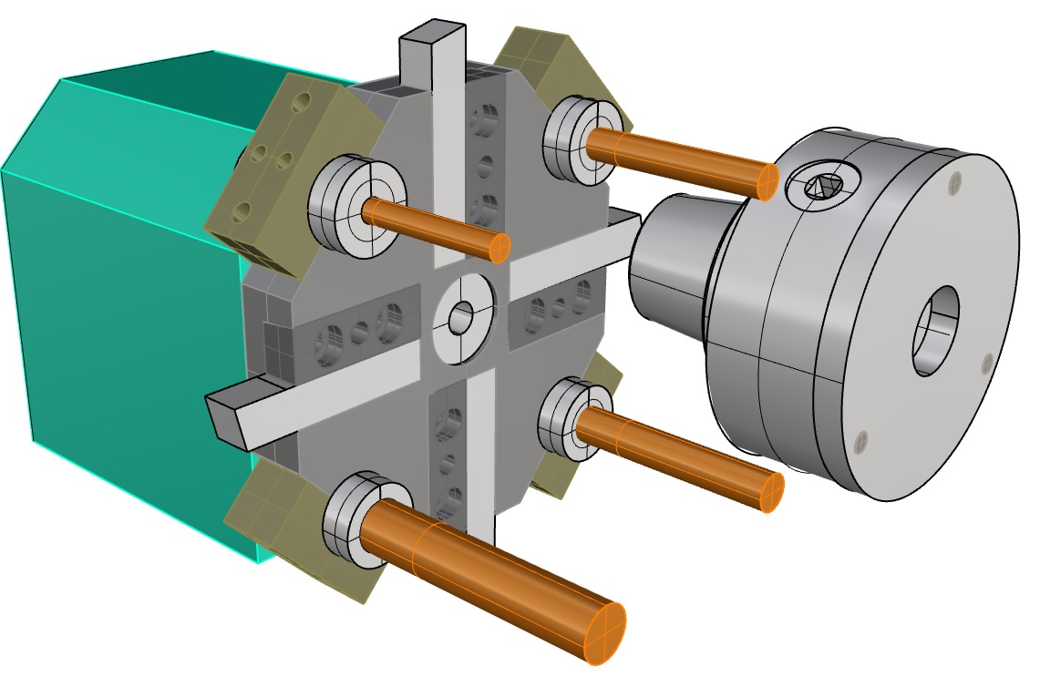

02 May 2021 16:47 #207653 by NoJo
That's a good start.
I was going to try to make the changes to configure the C axis, but I spent all day trying to get my 1921 motorcycle running.
Do you need the C axis urgently, or is it on the "nice to have this month" list?
So, how did the motorcycle go?? Read up a bit on what I could find on the internet - a colourful history that motorcycle has!
And, any revelations on my C axis? I am progressing well with the ATC - I think it should end up a neat implementation.
Just a lot of work ahead...
Joe

04 May 2021 09:58 - 04 May 2021 10:01 #207810 by NoJo
OK, tried that and have a few errors in the files.
First was [TRAJ] Cordinates = ZX without the C in the ini - fixed that ( XZC).
Placed the M100 / M101 files in CONFIG directory ( where should they go?) and made then executable ( permissions, etc)
Nexr error is an ini variable not found [JOINT_2]DIRSETUP...not found - see in attached report file.
I did dig in the HAL and ini files to see how that term is used in the other axes, to try understand where it is missing 'from' but did not succeed.
Still not smart enough with this to understand, but I do suspect that maybe the Stepgen allocation is not correct?
X uses Stepgen 00, Z uses Stepgen 01, Spindle uses Stepgen 02, but C_Axis uses Stepgen 01 as well..Should this be Stepgen 03 with the output somehow muxed to the spindle stepgen?
Joe
