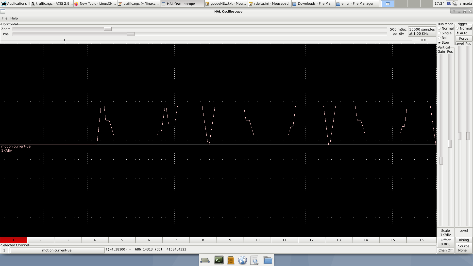

Good day.
Can I set a stable acceleration value?
In ini file I set all parameter acceleration is 30000 but I get 30k-45k and more.

acceleration is at the joint level. where two or more axes are all contributing to a move at their stable max acceleration, the total acceleration observed in a current-vel plot can exceed the joint acceleration because the acceleration vectors are summed

You can do this in a sim.
Try doing a rapid from x,y 0,0 to 1000,1000 and plot motion.current-vel and measure the time to get to speed and calculate the acceleration (It should be > 30000)
Then repeat the exercise moving from 0,0 to 0,1000 (which should respect the joint acceleration)
Note the values in halscope are in units/sec/sec not units/min/min.
Replied by rodw on topic Stable acceleration
Definitely Acceleration per the ini file. You can measure that in the halscope plot by looking at the time taken to get to the feedrate (the ramp up and ramp down in the plot).acceleration or velocity?
