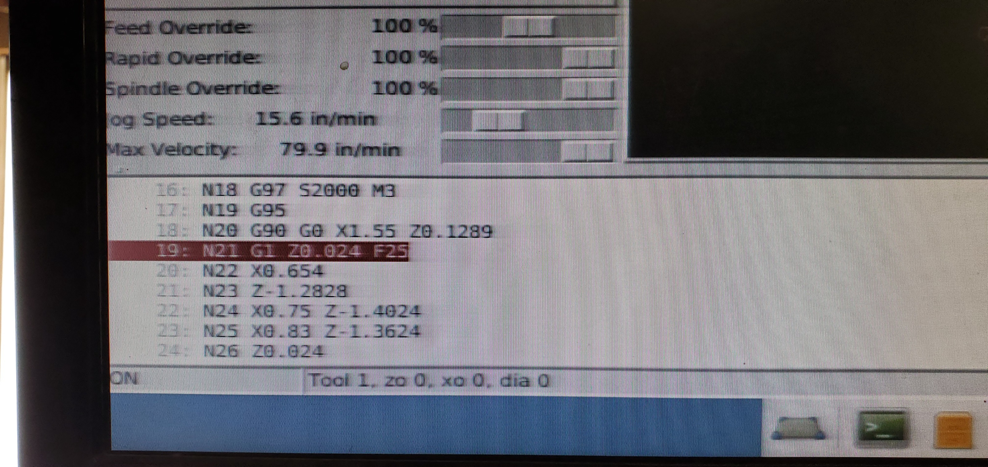

A few years ago, while I was setting up my universal mill (MAHO mh600c), I took Andy's advice, and made separate configurations for vertical and horizontal milling. It is working great (not that I've had much free time to use it).
I've recently started to think about making a third configuration to use the mill as a lathe. I started the configuration as a mill and then changed the ini. to lathe. Unused axis is set as Y. I can jog and home the Y. I would like to set up gang tooling along the Y with a different x,y,z touch off for each tool. Not sure how to do that.
I've tried to run with only one tool, just clamped in the vice for now. Post processed from fusion, but when getting to this line, the machine just freezes without an error. Not sure why.
Thanks in advance for any insight. I'm sure I'll have more questions as I proceed.

Replied by andypugh on topic Lathe configuration for mill
That looks like it is probably the first G1 move, so my first uess would be that "spindle.0.at-speed is not being set.
Last edit: 24 Apr 2021 19:35 by andypugh.

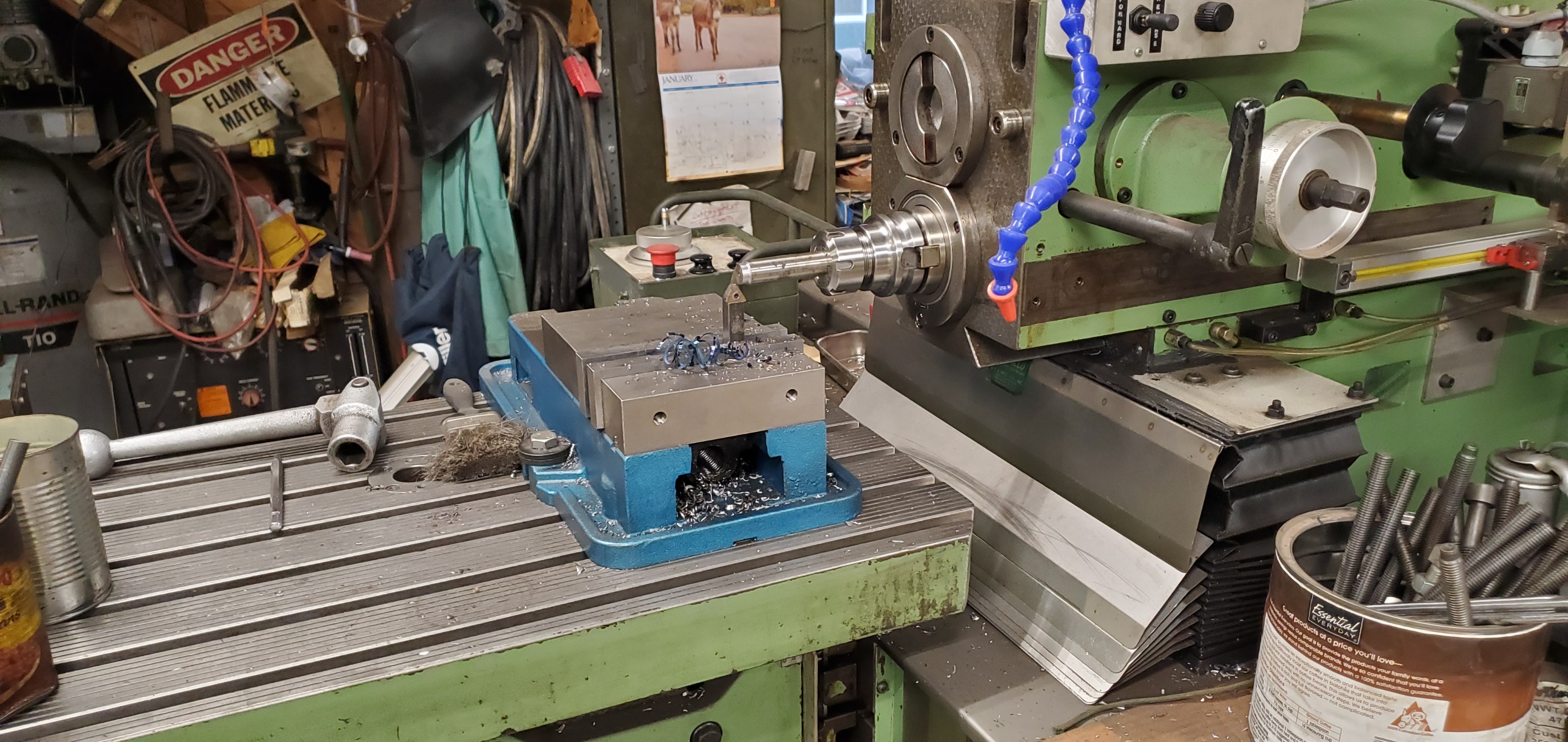

I have used my own mill as a lathe for particularly large work:
Have you seen anyone make a lathe configuration for their mill like this?
Not with tool changing, but I don't foresee any problems.
As far as the controller is concerned it is all just numbers, and HAL lets you send any numbers to anywhere.

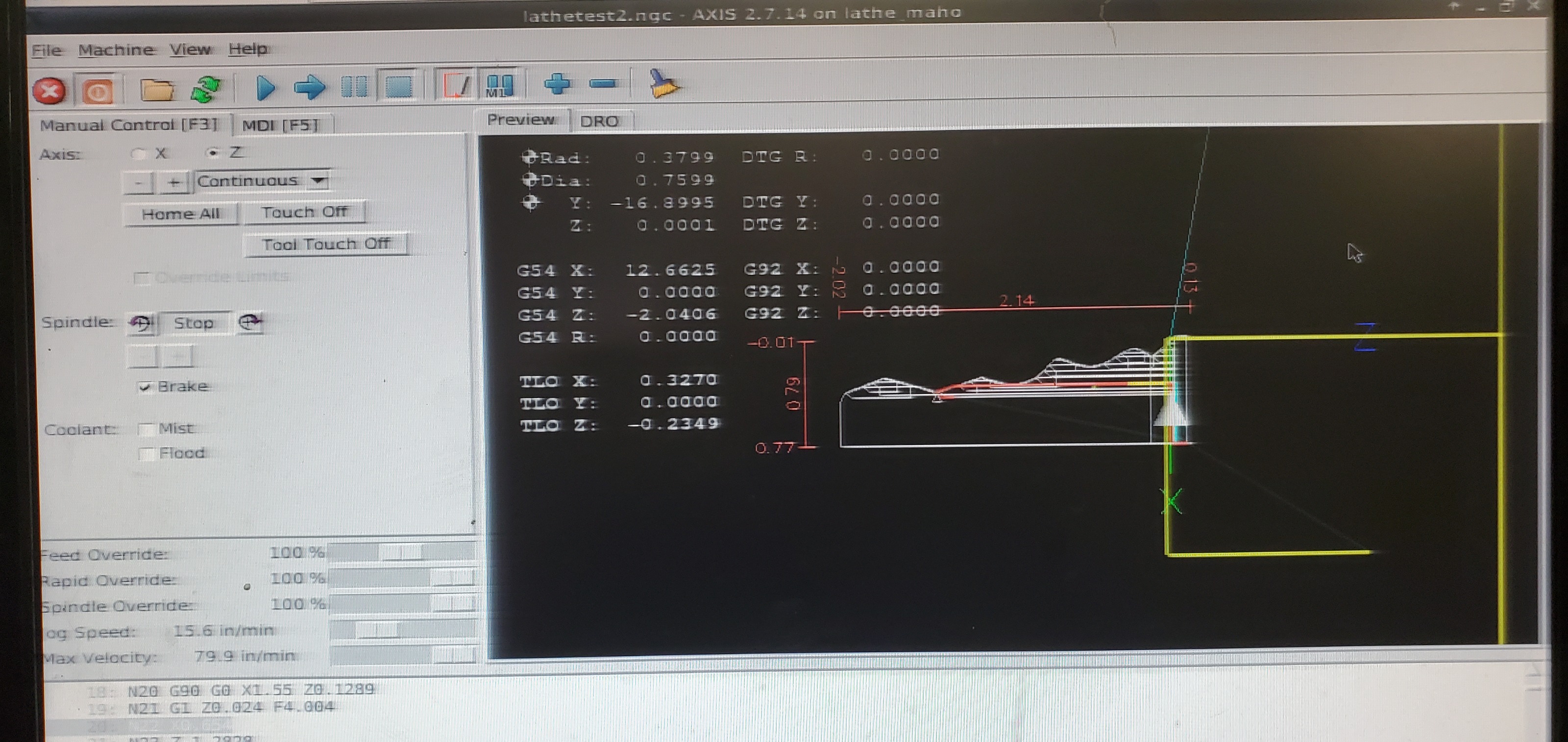

25 Apr 2021 10:42 #207025
by Mccartymachine1
Replied by Mccartymachine1 on topic Lathe configuration for mill
- Mccartymachine1
- Posts: 42
25 Apr 2021 11:09 #207027
by Mccartymachine1
G95 was active and I don't have a spindle encoder.
