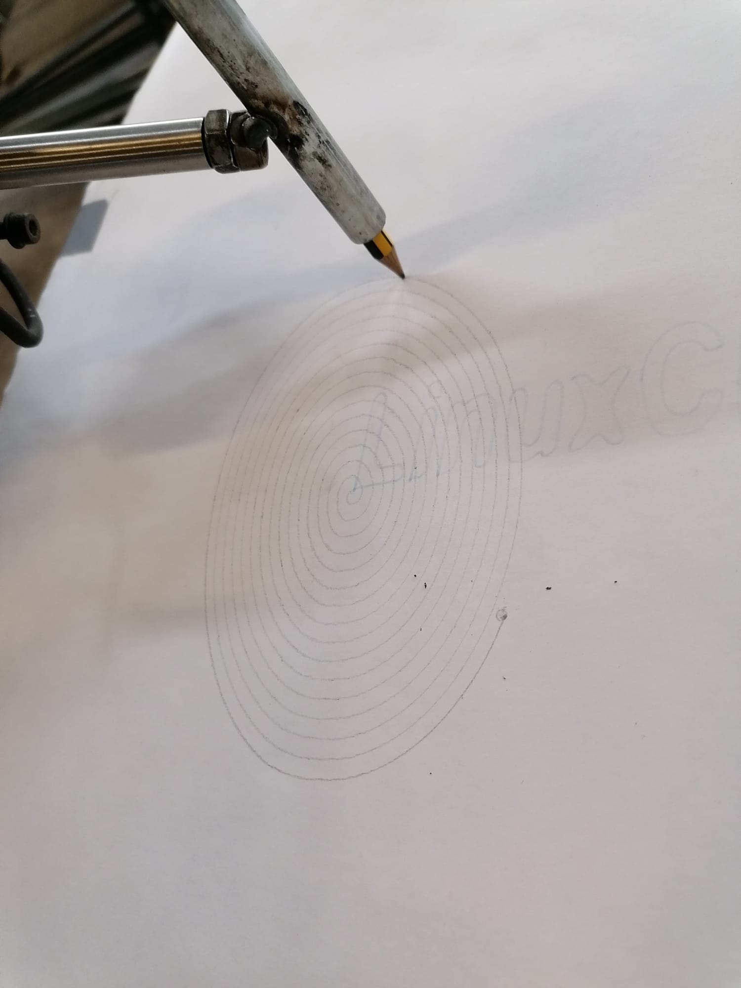

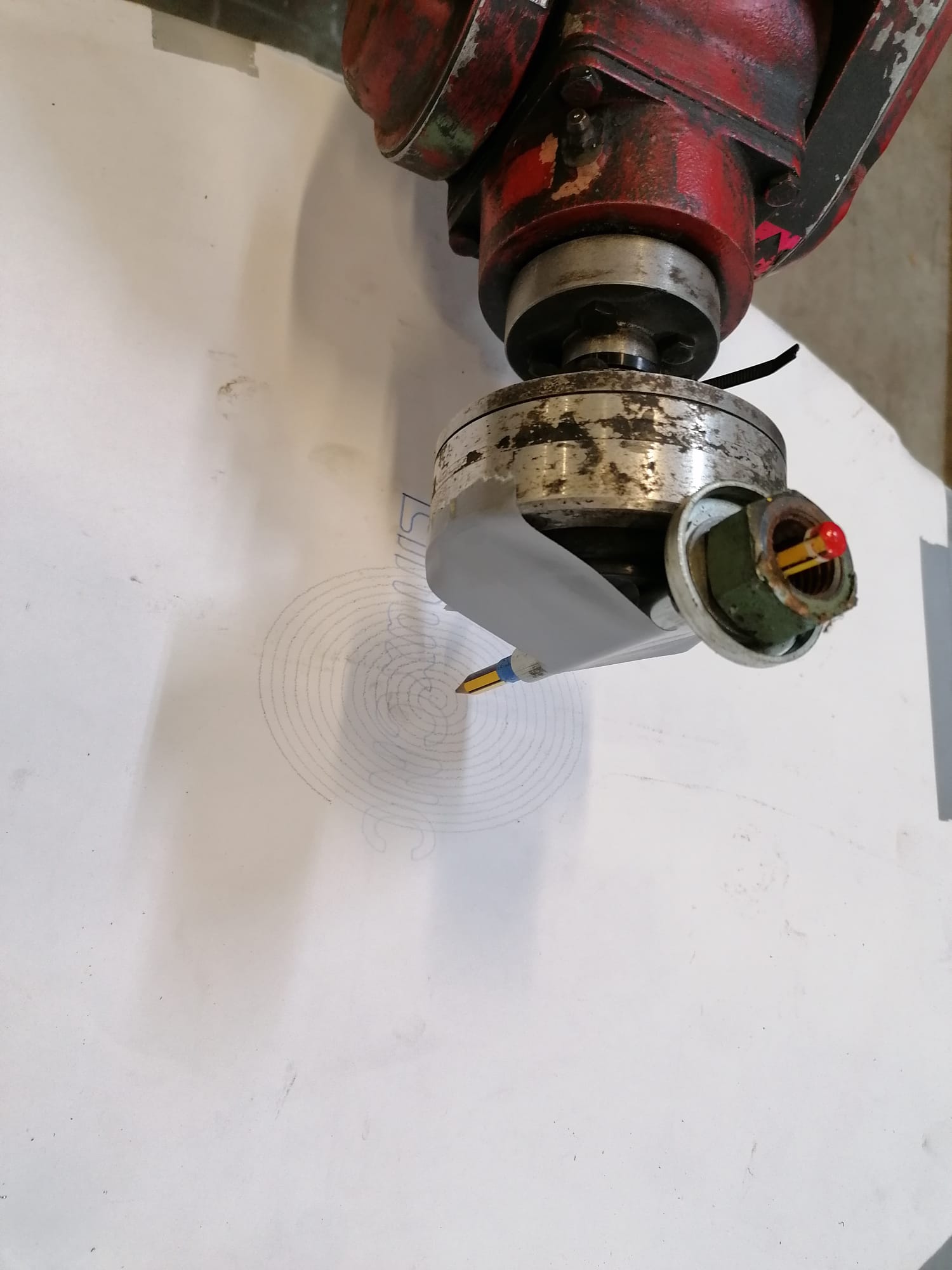

If i use a pencil to track the movement and try to make a circle in the X-Y plane, I get a circle when the robot points straight down. When the robot is facing in the X - direction (horizontal) i get approximately an ellipse. (Pictures as reference).
It seems thougt the distance of the tooltip to the last joint is neglected in the movement, but the X - coordinate is correct. Y - Movement ( if Y near to 0 +- 200mm is off by 30%.  X-Movement is spot on. If i turn the robot 90° and X is near 0, Y-Movement is correct and X- Movement is off.

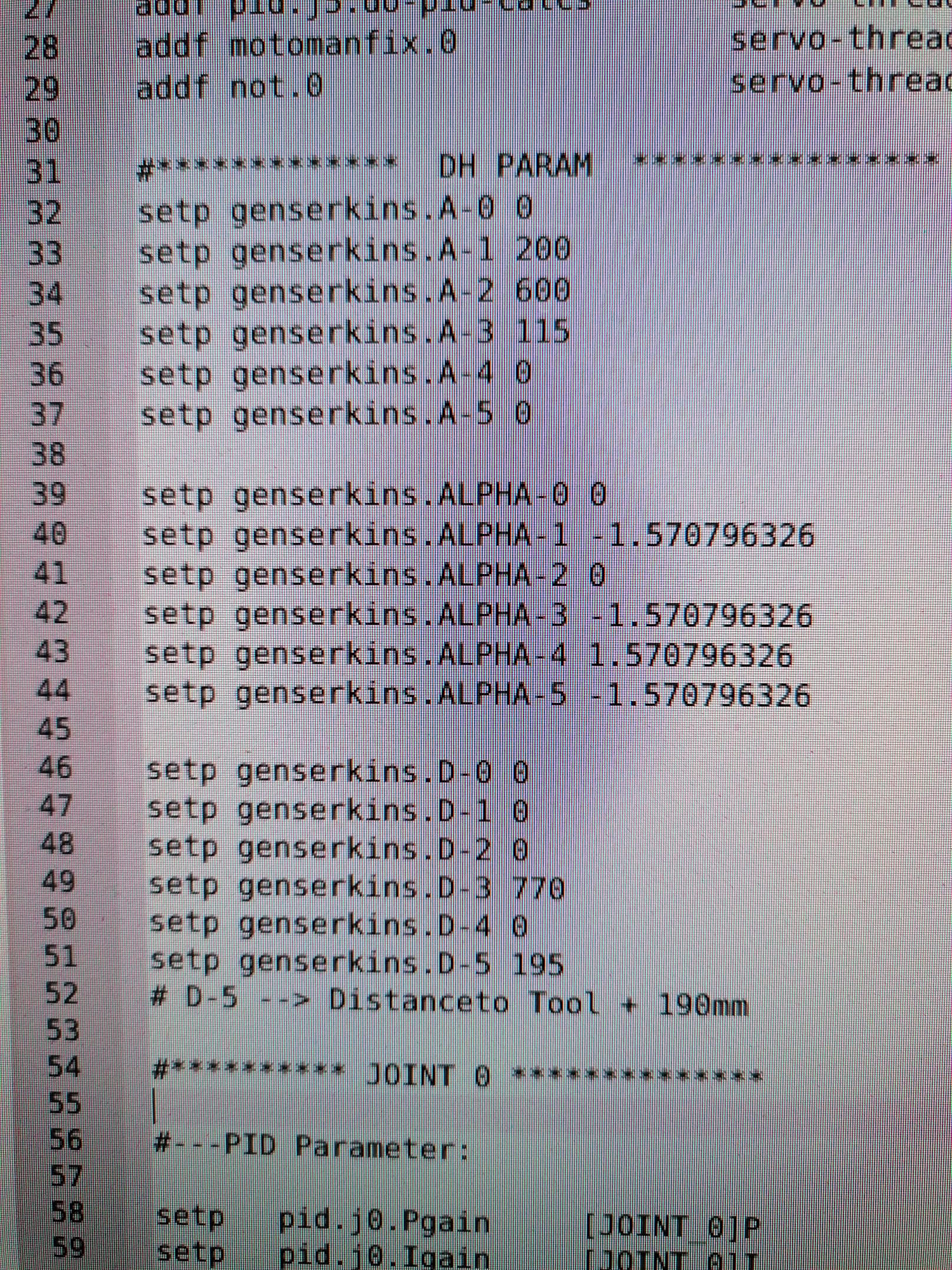

I followed the D-H Parameter tutorial and the Puma560 Demo helped a lot ( The robots are the simmilar in theconstruction and order of the joint - types, just the dimensions from joint to joint are different)
The DH-Parameter are attached.

I'm surprised the usual genserkins setup works for your robot with that lever mechanism. However, since you have an issue with 'sideways' motion, that doesn't seem to be causing your problem. Have you tried increasing your D-5 value to check if the offsets gets smaller?

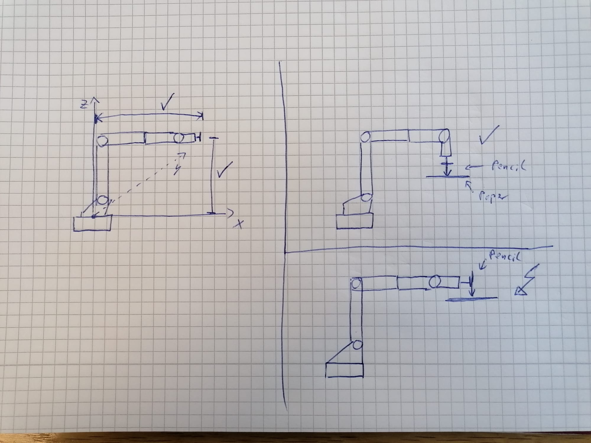

Are you sure your X-coordinate is correct when the wrist is horizontal as in the hand-drawn sketch on the left? If it is then D-5 parameter would seem to be correct.
Also, if you go from the horizontal to the vertical orientation does the z-coordinate value change by the value of D-5?
Looking at your parameter list (D-0 = 0), it seems that your origin is in your shoulder joint rather than on the base plate. Is that intended?
1. Yes i tested it multiple times.
2. I only measured the x - Value.  I will test the z - Value and then reply.
Yes its intended, this way, the z coordinate absolute 0 is near the Workbench surface. In absolute World mode its simpler to measure z height for me.

Also what you will want to check is the change in Y-coordinate value when you twist the arm to get the hand from vertical to a 'sideways' horizontal orientation (ie it should go from 0 to +/- D-5 value).

I found the problem when I turned joint 3 +90° and then joint 4 90°. The y-coordinate should be 195mm but it was -195mm.
The other directions were correct.
I switched the turning direction of joint 3 and 5. Now it works.
