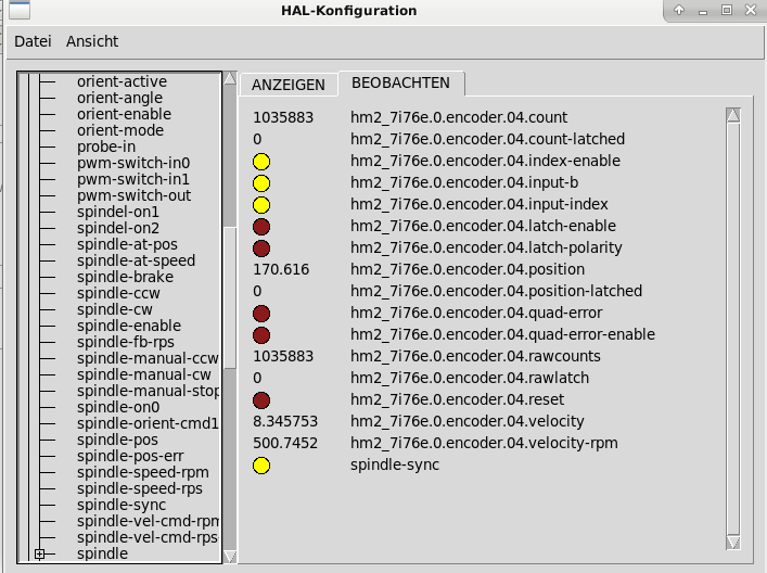

25 Dec 2021 05:58 #229955
by anton610
Replied by anton610 on topic Index signal for Orient, G33.1, M19 with proximity sensor
Hello,
many thanks for the inputs.
I've connected the signal correct (ttl, 0v to GND), measuring gives me also the values (0v, 4,08v)
when i run the command M19 R15 Q4 i get the error:
when i run G33.1 Z10 K2 i get the error:
when the spindle is stopped my halshow is:
when the sindle is at 500rpm:
maybe the hal or ini is fault...
maybe someone can give ma a hint, where to look.
Many thanks!
BR Anton
Many thanks!
BR Anton

25 Dec 2021 09:34 - 25 Dec 2021 21:32 #229962
by Henk
Replied by Henk on topic Index signal for Orient, G33.1, M19 with proximity sensor
ok, lets verify a couple of things first.
look at the pin spindle.0.revs in hal configuration. rotate the spindle by hand. this should go from 0 to 1, then reset back to 0 as you rotate. 0...>>...1 must equal exactly one rotation of your spindle...***edit: checked this on my machine, it counts up and down, does not stay between 0 and 1 as described above.
now, in MDI start the spindle with M3 S500, followed by G91 g33.1 z-20 k1 (assuming metric machine and G21 active) make sure that there is at enough space below the spindle to allow a -20mm move in Z direction.
if the spindle starts and runs, but no tapping action happens, your index signal is not detected, or the encoder direction is incorrect. for the latter you can swop A and B wiring, or you can set the encoder scale to -6071.428571428571 (negative) in your INI file.
It seems that your spindle is set up as a step/dir spindle. does it run? What functions are available in the drive? Position control mode selectable by an input signal to the drive?
I dont have any experiance with step/dir spindle setup. In your case, with the encoder on the motor and not on the spindle, you probably cannot use the drive orientation function and you should use Linuxcnc's orientation component, which seems to be the case looking at your hal file. Check the orientation mode, it needs to be set as either 0 or 1
henk
henk
Last edit: 25 Dec 2021 21:32 by Henk.

25 Dec 2021 09:56 #229965
by anton610
Hello Henk!
Thanks for your time and quick reply!
spindle.0.revs is counting to plus and minus as i turn the spindle. it does not reset to 0. (maybe thats the problem)
I have is enough space to go -20 in Z, spindle is on the top position.
Spindle is not starting get the error: "spindle is not turning in G31"
When i turn the spindle, the encoder counts to plus in clock direction and to minus counter clock direction.
The spindle runs CW and CCW normally. I can set the speed by S command without a problem.
I run the spindle in position mode, velocity mode (0-10V) and torqe mode are also available.
BR Anton
BR Anton

25 Dec 2021 11:22 - 25 Dec 2021 13:33 #229972
by anton610
I think i have a wireing problem. Now when i measure the input for the encoder (proxy sensor) idx+, I have 4v and triggered 4,9v.
When i disconect the sensor from the encoder input and i measure i have 0v and triggered 4,08v
Thats bad...
Thats bad...
Last edit: 25 Dec 2021 13:33 by anton610.
- Posts: 18119
- Thank you received: 5337
25 Dec 2021 14:40 #229983
Replied by PCW on topic Index signal for Orient, G33.1, M19 with proximity sensor
The encoder inputs have a 2K Ohm pullip resistor to +5V so if you use a
resistive divider it needs to have a quite low resistance, say 220 Ohms on the
low side and 1K Ohms on the high side
