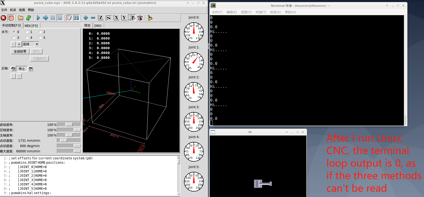

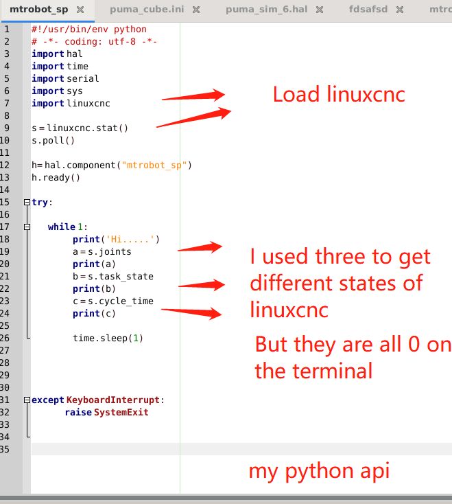

Hi, brothers
I have a Linux CNC program. The ". Ini" file and ". Hal" file have been configured.
Now I want to write a python API to talk to Linux CNC. Get the status of Linux CNC through Python API
I found the instructions on the official website:
“ linuxcnc.org/docs/stable/html/config/pyt....html#python:reading -ini-values”

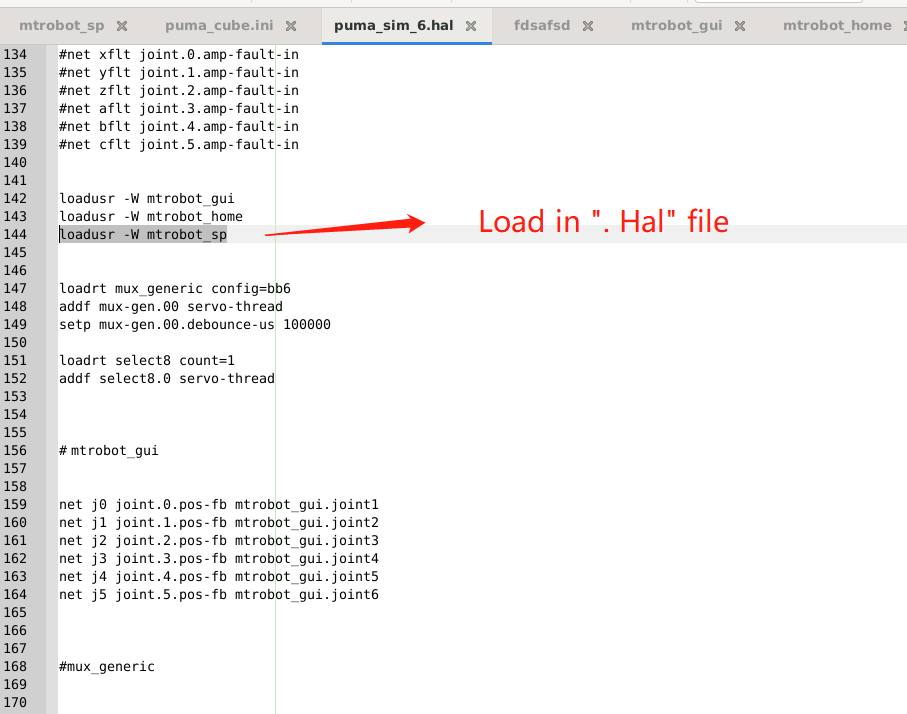

I wrote the python API file according to the instructions and loaded it into the ". Hal" file.

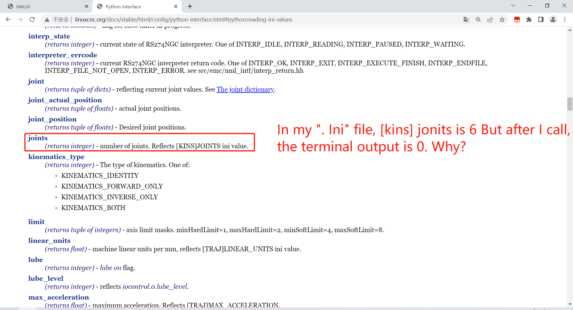

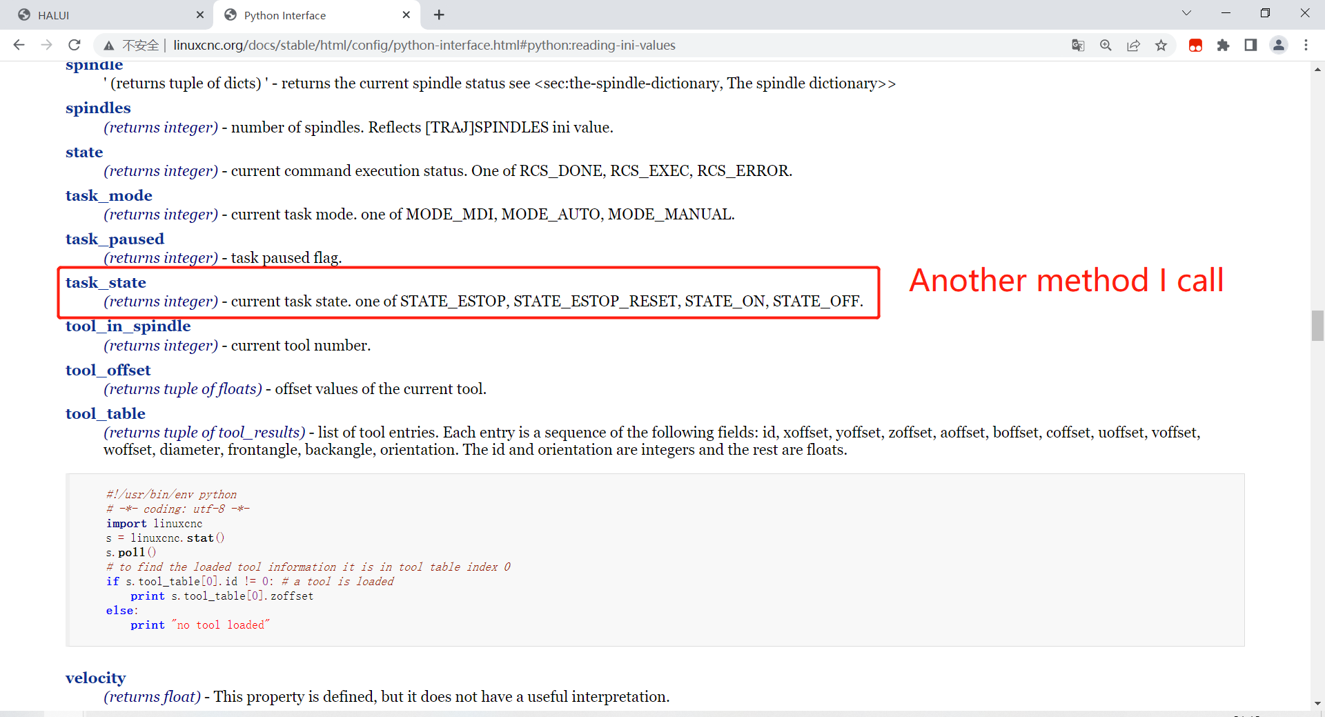

I run linuxcnc and find that all the printed ones are 0. Why?
I only get three basic attributes in the python API, which are:
joints , task_ state , cycle_ time
These three values can't be 0. Is there something wrong with my program?
I'll put my Python API, the ". Hal" file and the basic attribute pictures I use below
Thank you

You need
s.poll()
In your loop to update the values.
(it needs to be in the loop, to run every cycle and update the values)
