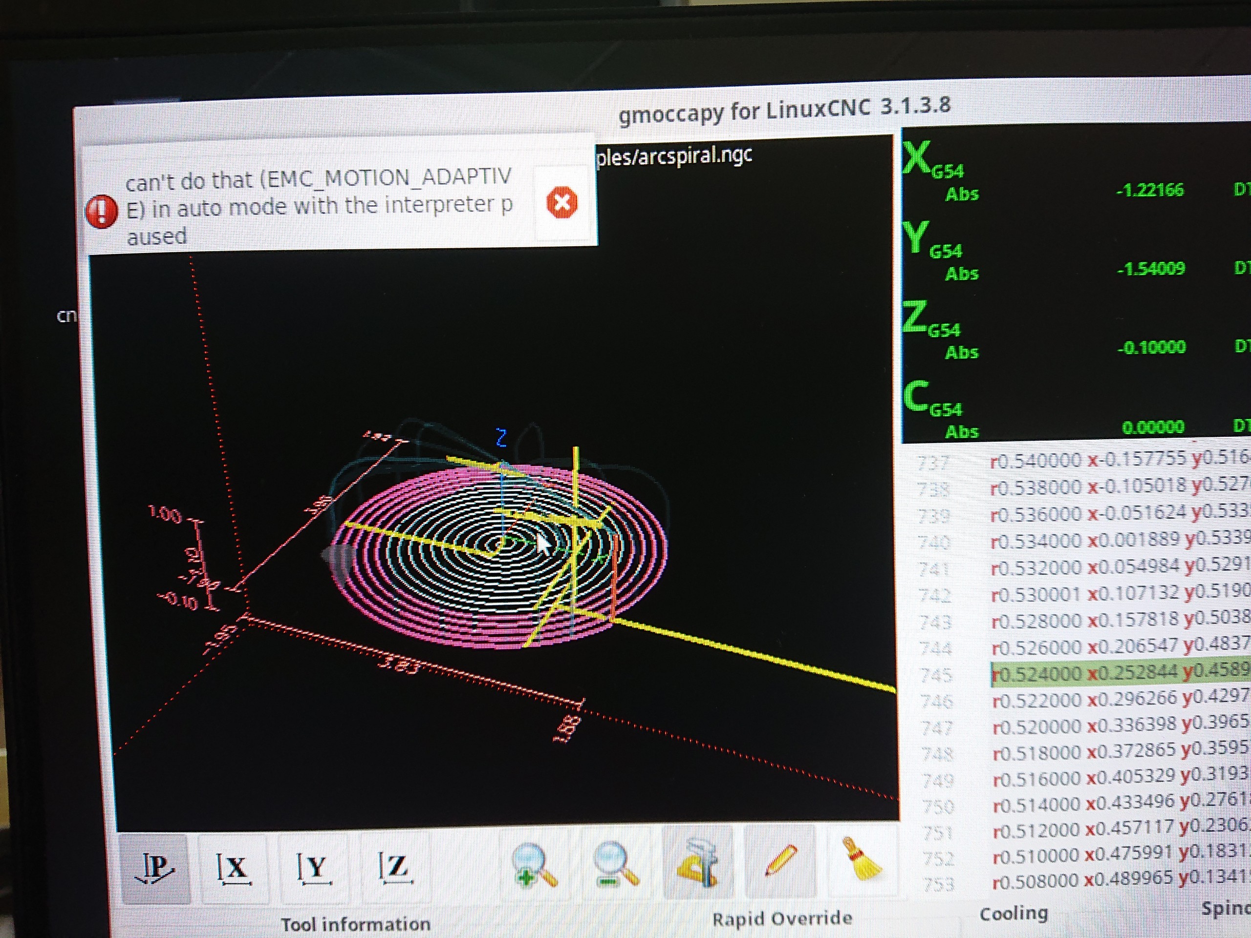

i trying change by python
i want switch adaptive mode via external push button like syntec
import sys
import linuxcnc
c = linuxcnc.command()
s = linuxcnc.stat() # create a connection to the status channel
s.poll()
c.auto(linuxcnc.AUTO_PAUSE)
c.set_adaptive_feed(1)

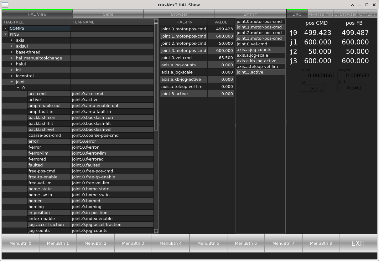

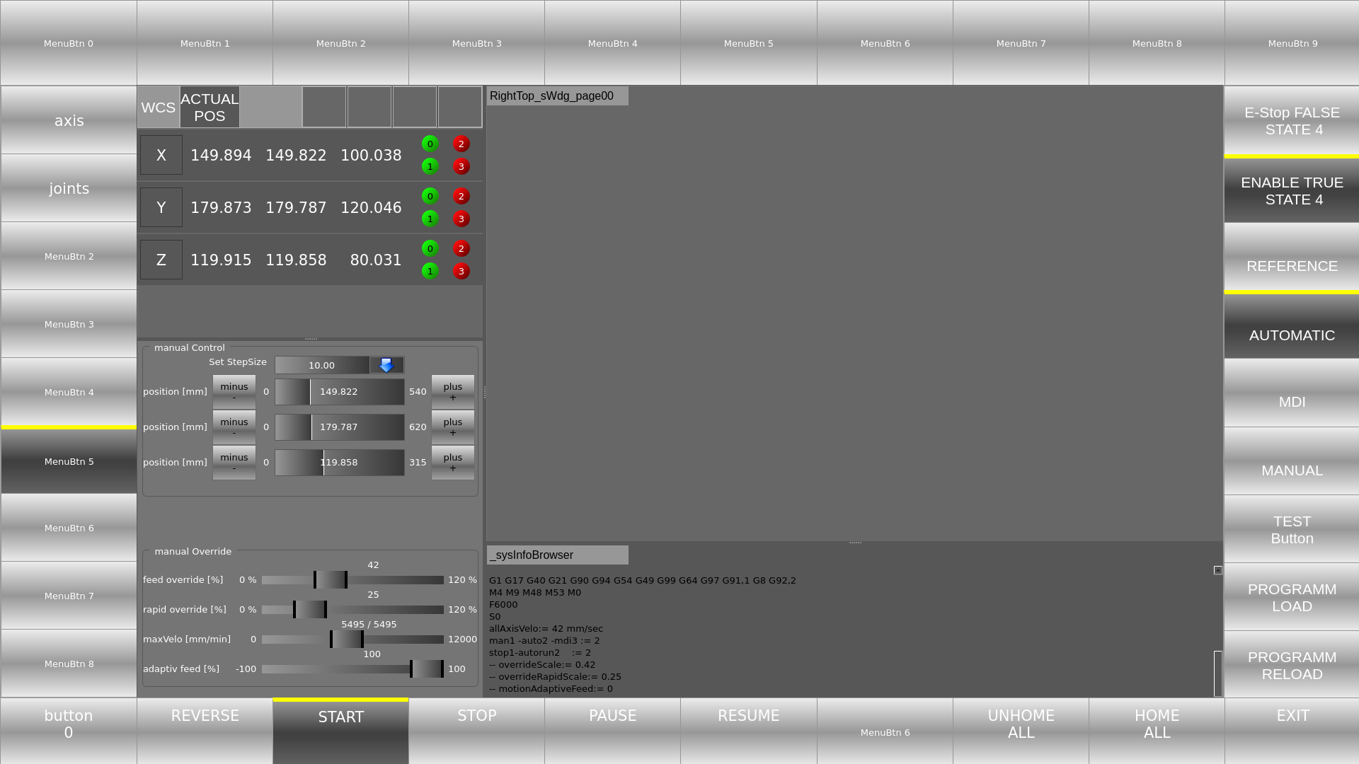

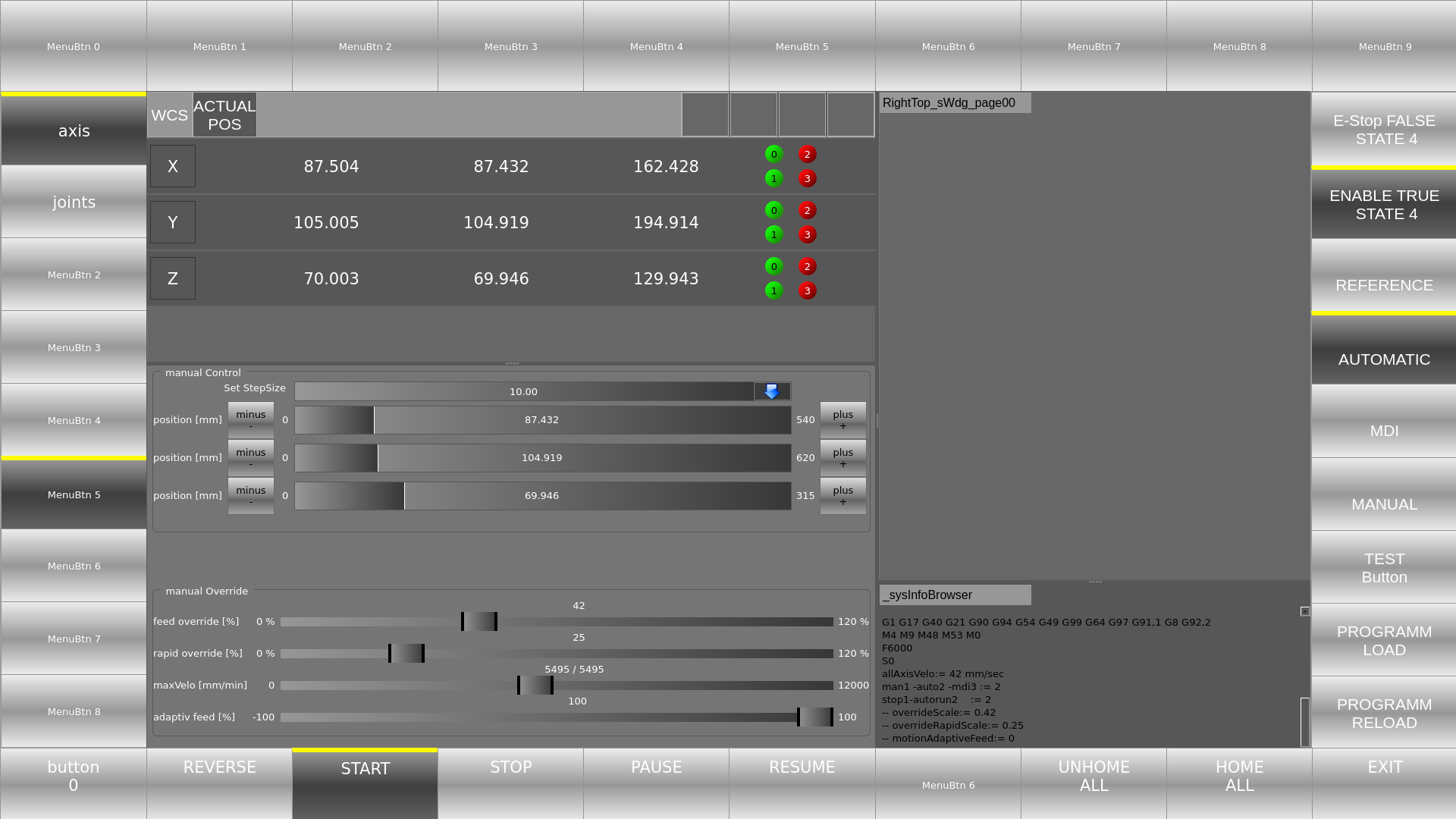

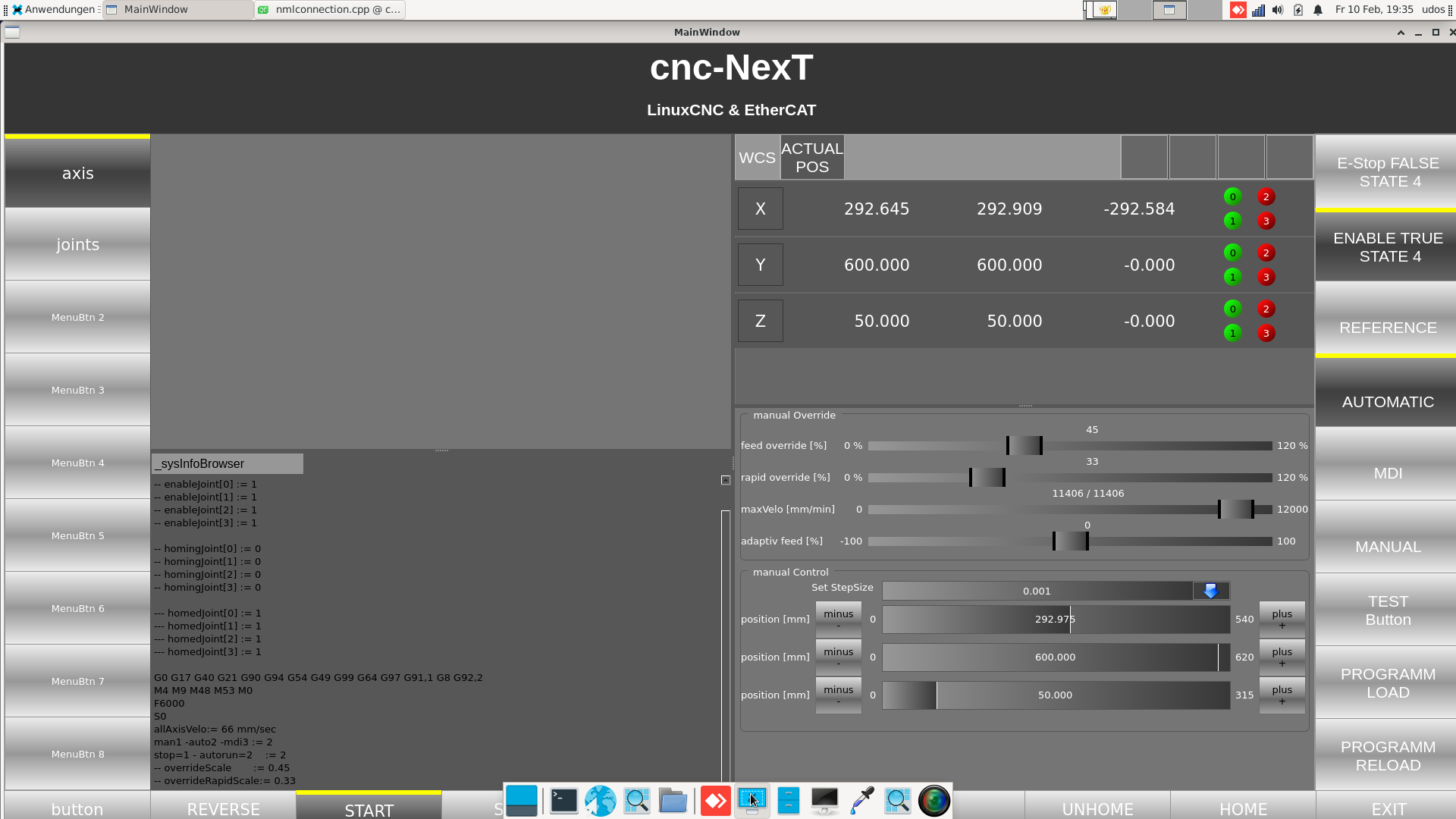

@andypugh or any one can help
How would I set the adaptive-feed value with a nml-command? if there is one;
just like setting EMC_TRAJ_SET_RAPID_SCALE or EMC_TRAJ_SET_MAX_VELOCITY ??
thank's in advance

Replied by cmorley on topic Adaptive-feed , any solution change in auto mode
looks like there is only a message to enable/disable it.
Setting the value is only thru HAL

@cmorley thank's, I was almost expecting that;
What would it take ( How To ) to implement that input into the nml-channal;
23. Adding custom NML commands....
I think I'm not ready for that just yet; .... GGgggrrrr;
Why can't you just set the HAL pin?

@cmorley thank's,
Yes I could do it, using the halPin;
But up to this point the UI is just depending on the NML channel;
I wanted to avoid the HAL, and just see how far I can get; that's all.
