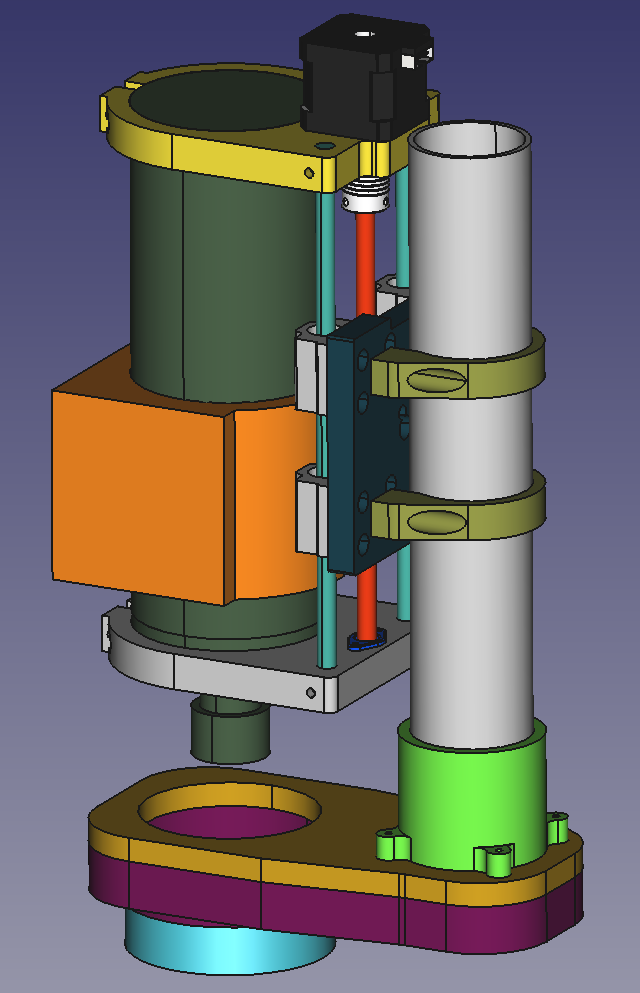

Interesting. I have just built a W, z attached dust shoe myself and started to look into getting it into HAL. Think I have almost the same requirements as you with manual override, auto-follow, park when tool changing etc. Would you mind sharing your ini file as well? And the rest of your HAL files, I'm missing the components used in your HAL above.

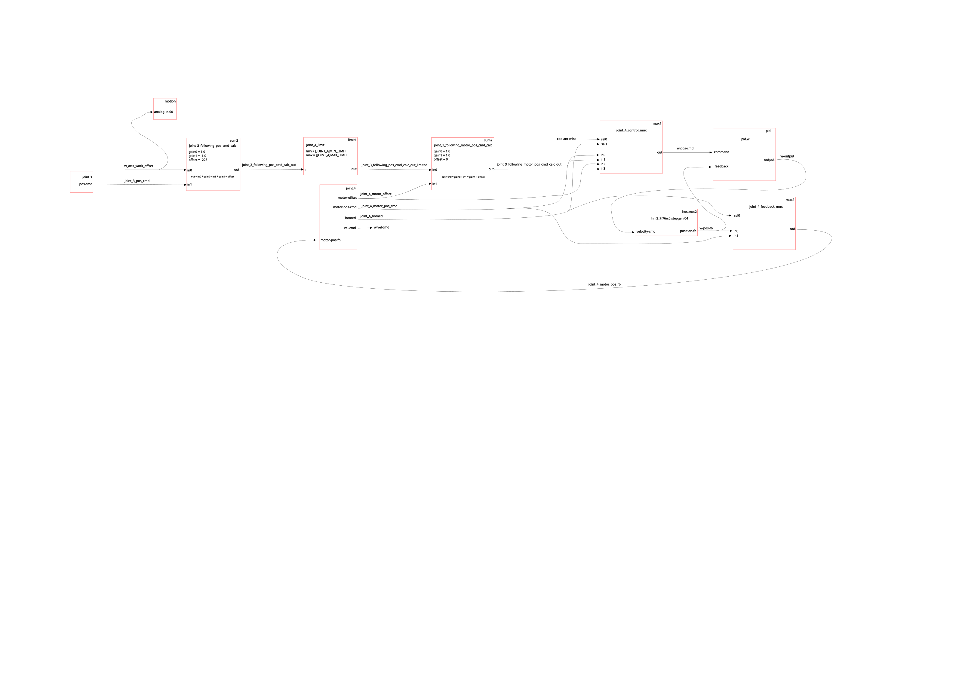

Ok, think I have figured it out, most of it at least. Had to make a visual representation of the HAL finnstrom posted. See attachement. Also got it sort of working on my machine. Tanks so much!Some things I'll try to adopt
