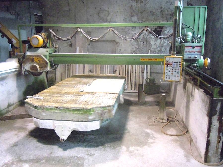

Hello
I am working on a project, to convert an old bridge saw cutter for marble with rotating table for the work piece
to a cnc milling machine. My question is how to configure the kinematics of the 4-axis system.The tool is a disk saw (20cm .. 30cm diameter)
that moves in x,y,z axes and at the same time the work piece table can rotate when making curves.
I am going to use servo drives with analog reference inputs and incremental encoders for feedback.
For the logic interface I will use some mesa cards.
Any suggestion for the appropriate cam processor for the gcode generation of dxf files?
I am already familiar with linuxcnc and mesa cards that i have used in the past on other projects.
Thank you in advance.
George

This sounds like a fairly conventional XYZC machine.
Do you need to coordinate the table rotation to the other motion, or us it largely indexing?
23 Sep 2023 03:15 #281444 by glct12
The axis C is rotating relative to Z axis and coordinated with the other motion.

23 Sep 2023 03:51 #281448 by glct12
The machine is similar to the one in the picture.
The table (C axis) is rotating relative to Z axis, which is perpendicular to XY plane.
The disk diameter could be 20cm in minimum.

23 Sep 2023 18:54 #281517 by tommylight
Replied by tommylight on topic bridge saw cutter for marble with rotating table
Posting a real picture of the actual machine would save us a lot of time trying to guess, so why don't you?
The picture you posted, that is not of your machine, i have seen those and have access to if the need arises, but much bigger. Same everything, but bigger, Italian made, NC controlled, etc.
