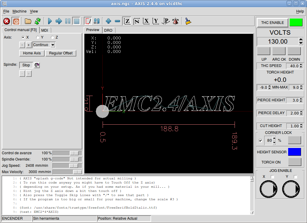

Hi all
I was writing a new comp for thc boxes.
FIRST OF ALL I AM NOT A PROGRAMMER
So ,please, apologize if the program has a bad style
I believe is now ready for testings ( I am using it since two mounts and look fine ...)
BUT STILL EXPERIMENTAL (off course:-)
Hoping someone will find it useful

Hi
I am looking at a number of possible THC configs and yours looks about the easiest one to implement. I see it has been some time since you posted this, is it working ok?
I will make some changes to use my own THC.
I have to ask, why are all the THC configs so complex and your look simple? Is it because you use a component?

Hello
Yes , look so simple because all the heavy stuff has been integrated in the COMP.
I was having problems to find a Gcode to set offsets , so I try to modify a thc comp for i520.
Finally I realize that was better rewrite the entire comp .
Was my firs attempt to write a realtime program and I think this can be done much better from someone with more experience in software
( I am just an harware technician learning C language).
I was implementing more and more inside the comp and at the end the comp make all the complicated job .
We are working more than year without problems , but just on one machine .
The comp is made to work with my own digital height controller but may work with others Thc boxes ,
off course you will loose the possibility to change from user interface Axis the cut voltage, but it will vork fine .
I will be more then happy to help you to test this comp on your machine.
Best regards

I started to test my machine. Not the plasma side just yet. I made some changes to your code to work with my own setup but the bulk is still the same.
I found that the Z axis is very sluggish under manual control or jogging. Do you find the same?
What is your server thread time period set to? I think this might have an influence here.

Roberto,
I wanted to thank you for your vlcdthc work and files. I have your setup working on my table in test mode. Thank you very much!
Paul

Thank you for that, gave it a try today and made most of the things work just fine, but, the Zaxis is messing up badly. I removed the "voltage" pins since all i have for signals is arc_ok up down and thc enable with torch on, that is all working. The Z problem and the float switch is totally ignored as a home switch, Z moves the set distance at normal speed and as soon as it reaches the set value it speeds up immensely, giving an M3 moves the Z axes randomly again at various speeds ( mostly way beyond what machine can handle ). If i get a torch start raising and lowering the metal it moves the head just fine up and down. I did say "IF" . The Z positioning is............... never mind, will fidle some more with it soon.
Thanks again, and i will post details when and if i make it work.
