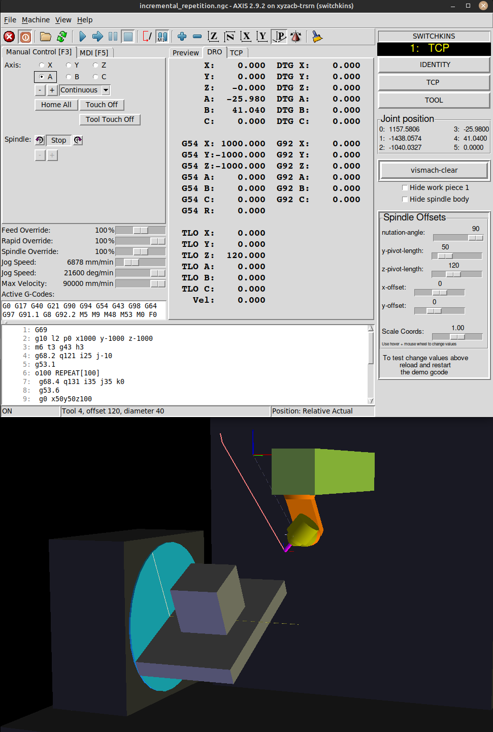

Replied by Aciera on topic Need help in implementing kinematics of 5 axis XYZAB configuration
You will need a custom kinematic for that. I did some work for a 6 axis kinematic that should also work for you. Have a look at the 'xyzacb-trsrn' config in the zipped folder here:
forum.linuxcnc.org/show-your-stuff/49103...-head?start=0#271334
Notes:
- for your purpose set the 'nutation-angle' to 90
- leave the C spindle rotary at 0 (ie just ignore it since your machine does not have a C-axis)
- for more information have a look at the Documentation folder included
Notes:
