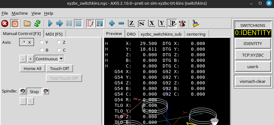

I believe that the method you linked to is used to add a custom kinematic to the sim configs listed under section 2. So I just tried it:
Created a file 'mykins.c':
2. compiled on my RIP installation:
3. start 'xyzbc-trt.ini' and SWITCHKINS 'userk' now uses 'mykins.c'
SO If you do not want to add another kinematic to one of those sim configs then this likely will not do much for you.

}2. compiled on my RIP installation:
user@user-iMac:~/git/linuxcnc-master/src$ userkfuncs=emc/kinematics/mykins.c make
Reading 203/203 dependency files
Done reading dependencies
!!!USERKFUNCS=emc/kinematics/mykins.o
Reading 272/272 realtime dependency files
Done reading realtime dependencies
Compiling realtime emc/kinematics/mykins.c
Linking ../rtlib/genhexkins.so
Linking ../rtlib/genserkins.so
Linking ../rtlib/xyzac-trt-kins.so
Linking ../rtlib/xyzbc-trt-kins.so
Linking ../rtlib/scarakins.so
Linking ../rtlib/pumakins.so
Linking ../rtlib/5axiskins.so
You now need to run 'sudo make setuid' in order to run in place with access to hardware.3. start 'xyzbc-trt.ini' and SWITCHKINS 'userk' now uses 'mykins.c'

Replied by mariusl on topic Custom kinematics
Well I would never have guessed that it was for the sims only.
Thanks for clearing it up for me.
