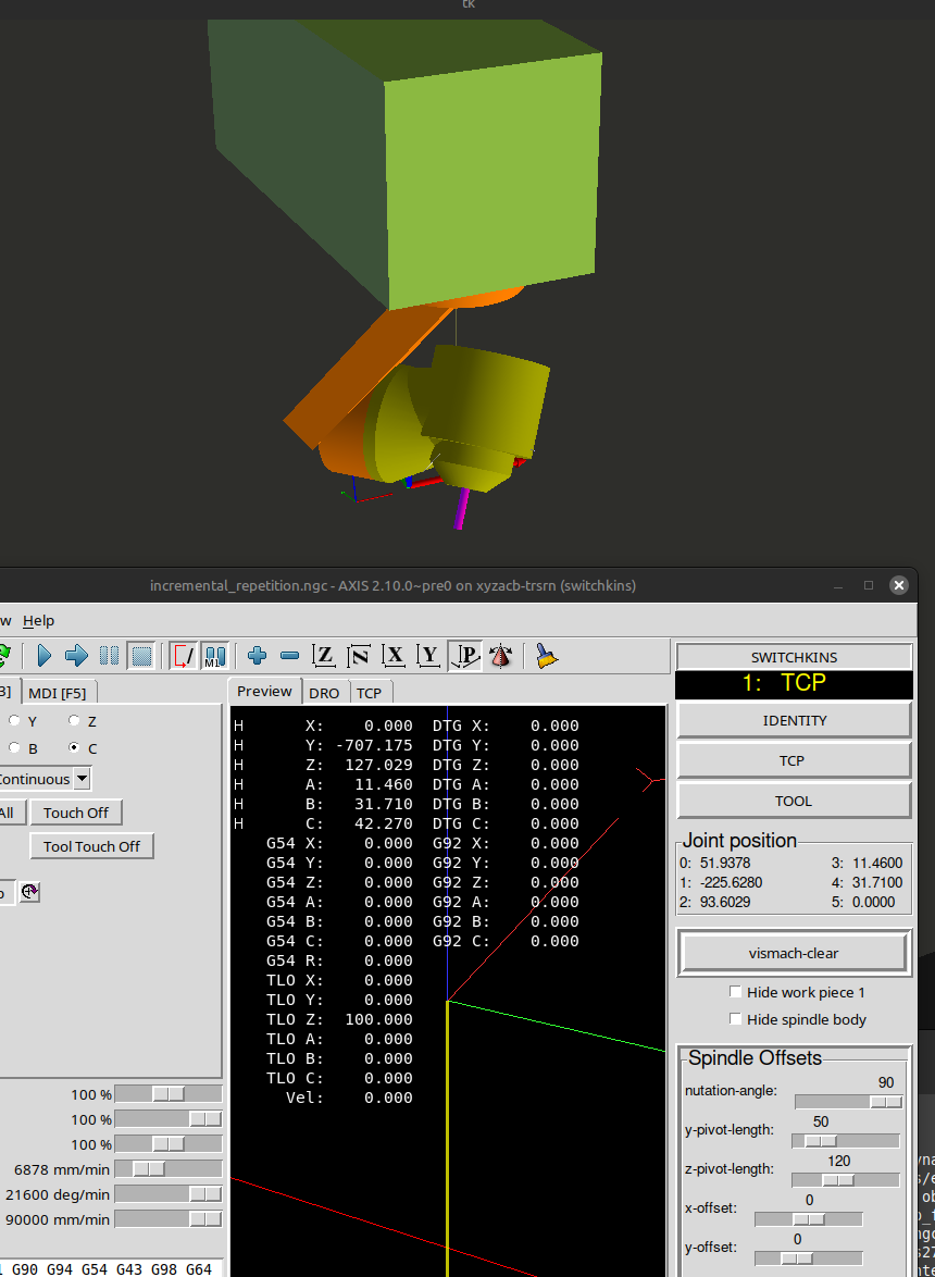

Hello,
How should I add RTCP feature to a 5-axis machine with the same joints as the machine in the video?

You can also try your luck with the somewhat dated 'bridgemill'
configs/sim/axis/vismach/5axis/bridgemill

Thanks for your answer. Can Gmoccapy screen be used for this kinematics?

The GUI is independent of the kinematics the custom panel on the right side is not strictly required for the functionality.

thanks a lot,It works fine in simulation. I will try to adapt it to my own system.
