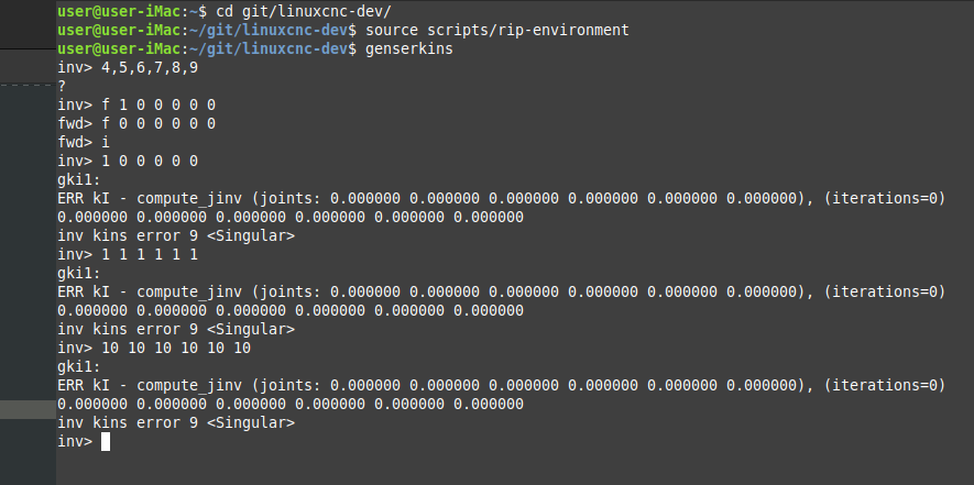

When i try run usergenserkins in terminal by typing genserkins to test something, i got this error:
HAL: ERROR: duplicate component name 'usergenserkins'
HAL: ERROR: component -22 not found
Segmentation fault
I'm running linuxcnc 2.9.4
Segmentation fault

I'm not exactly sure what that means but looking at this note at the beginning of 'ugenserkins.c' makes me think that you might be trying to use something that is likely no longer working:
Replied by Aciera on topic duplicate component name "usergenserkins"
* !!! Declining usage
* !!! This userspace program was been separated from the original
* !!! genserkins.c as part of refactoring kinematics for
* !!! switchkins support. The userspace program has not been
* !!! updated since 2009 (commit 1939285758) and correct
* !!! functioning in its current state is doubtful.
* Description: ugenserkins.c
* Test program (originally part of genserkins.c)
* License GPL Version 2

Yes, it is. In lcnc 2.8 i can run it by typing "genserkins" (not halrun) in terminal, but from 2.9 it seperated to ugenserkins.c and no longer work. I'm trying to add base and tool transform for this module.
