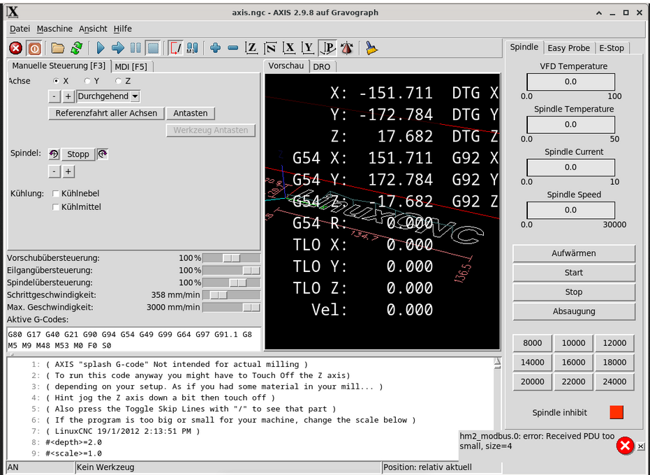

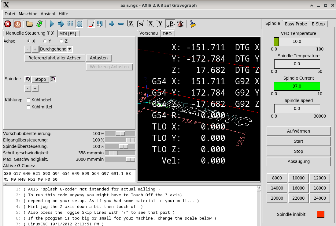

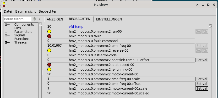

How can i Check this fault status ?
this way ?
this way ?

06 Feb 2026 19:51 #342562

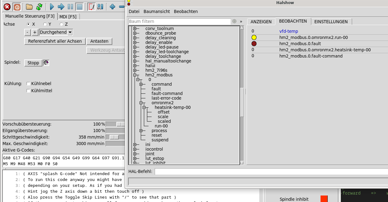

Replied by PCW on topic Configure Mesa 7i96s and pktuart with Omron MX2 (wj200)
No fault but seems like something very basic is missing/wrong
maybe in the hal file?

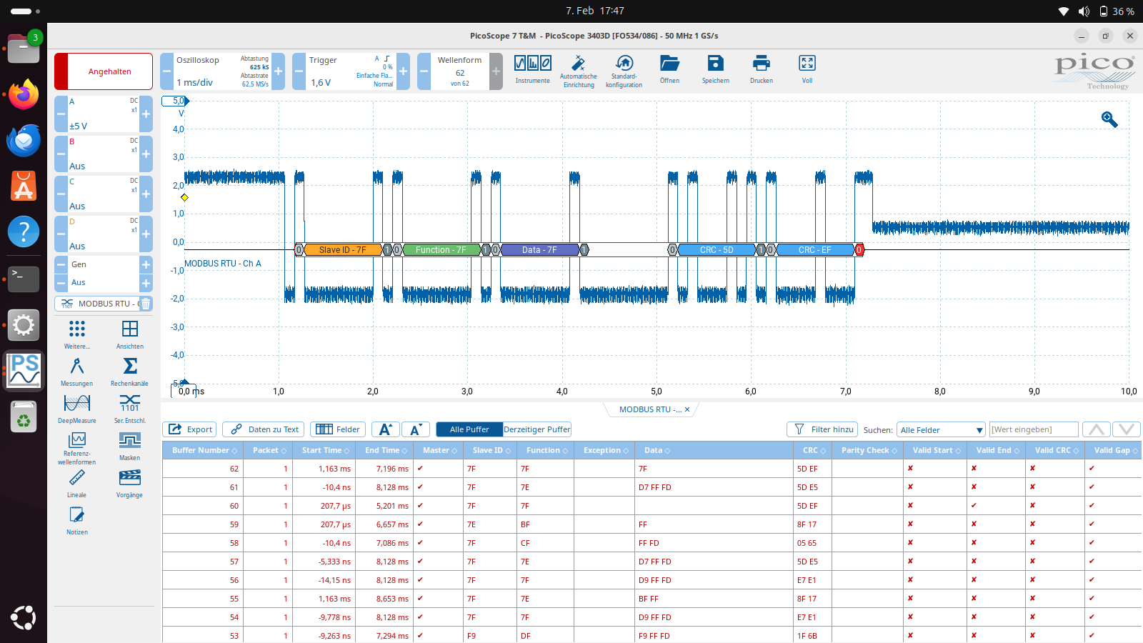

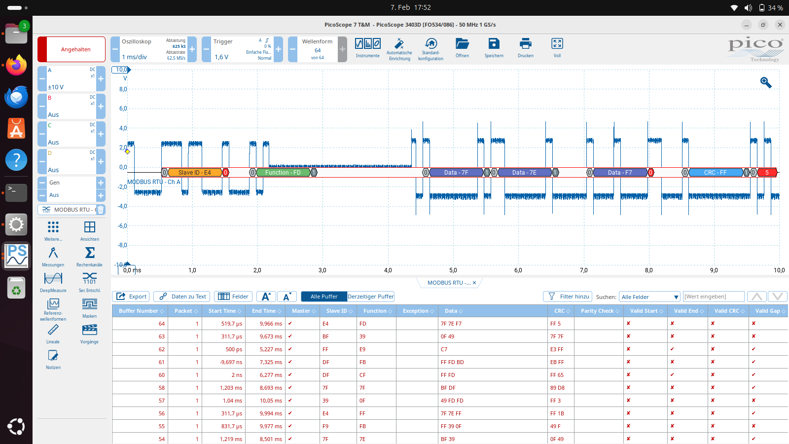

Hey Guys,
bad luck. The communication seems to run between mesa and Vfd.
Now i measured (in parallel) the connected Mesaoutput with Vfd Input. (mesa_modbus.png)
Compare to the connected USB-Dongle output and Vdf Input (USB_Modbus.png)
Signal Quality looks pretty good. (pktuart seems to work)
I figured out by using the USB-Dongle, that i have to set some Frequency to get this RUN-LED flashing on my OmronMX2 Vdf.
So I implemented all the other necessary Hal Pins to .hal file to check this with the Mesa <--> Vdf communication.
Know, if i click the CW AXIS GUI Button, Iḿ getting the same Error at my Vdf ( E12.1 like a few days ago).
From my point of view, there must be something wrong with the run, reverse or cmd-freq command.
Or still some wrong configuration somewhere.
Iḿ still getting no Vdf temperature out of the Vdf.
so write or read is not Working,

- Stephan@work
- Posts: 11
08 Feb 2026 08:40 #342634
by Stephan@work
Replied by Stephan@work on topic Configure Mesa 7i96s and pktuart with Omron MX2 (wj200)

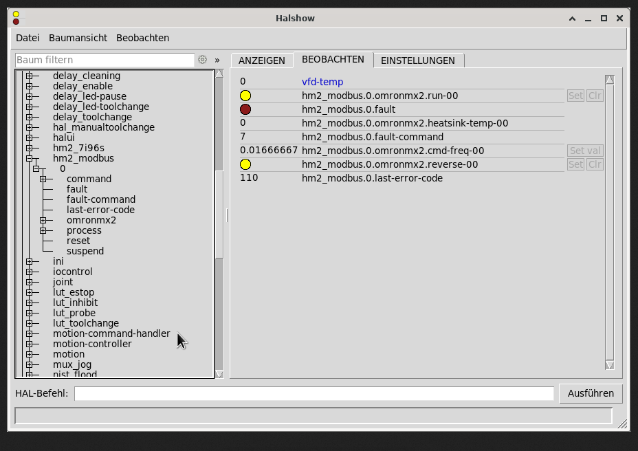

this hm2_modbus.0.last-error-code ?
it looks like:
• 110, 0x6e (ETIMEDOUT): The command received no reply and timed out.
But I 'm not sure if this was some consequential error.
I compared the running wj200.comp example of my USB-Dongle
but i can´t see any difference. Do I need some delay somewhere .
I added some interval="1000" like you did in your gs10. but no success.
it looks like:
