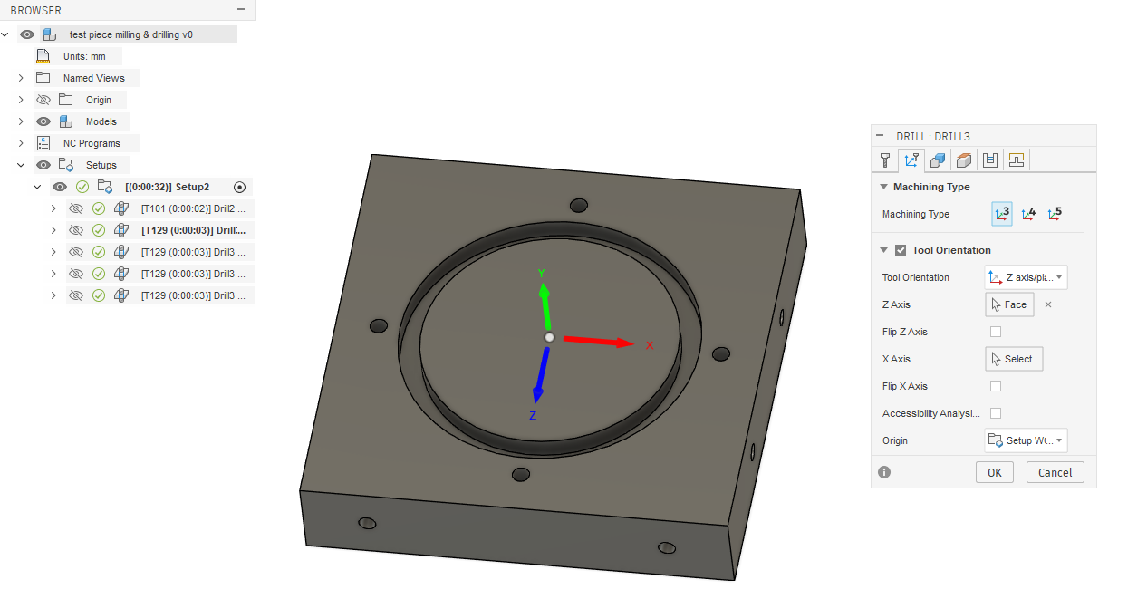

Hello,I am currently retrofitting a Biesse Rover 336 with LinuxCNC.The machine is controlled with a Mesa 7i77, and I am using EtherCAT modules distributed throughout the machine for the I/O.Originally the machine had a Control Techniques Unidrive VFD, but I was unable to change the required parameters, so I replaced it with a Danfoss VFD, which is now working well.At this point the machine is mostly operational:
Error: Function 'positionABC' can only be used with multi-axis machine configurations.
Error at line: 2040
Error in operation: 'Drill2'I suspect this may be related to how I defined the horizontal drilling operation.Is there a recommended way to program horizontal drilling for drill banks in Fusion when targeting LinuxCNC?Any advice from people who have implemented drill banks or horizontal drills on router-style machines would be very helpful.Thanks!

07 Mar 2026 10:30 - 07 Mar 2026 10:51 #343992
by hmnijp
Replied by hmnijp on topic Rover 336 retrofit – horizontal drills and tool offsets in LinuxCNC
In LinuxCNC, the XYZ tool offsets applied via G43 work correctly for the tool.
You can apply them inside M6 by executing G43 inside remap, or separately — it doesn't matter.
The error you are receiving indicates that you have changed the tool orientation (rotated the WCS). The post-processor checks whether your MachineConfig can perform an ABC coordinate system rotation, but you most likely have a standard 3x configuration.
However, to use drilling in planes other than XY (G17) without WCS rotation, you will need to change the post-processor logic in Fusion 360. The standard LinuxCNC-EMC2 post does not allow this. The standard 5x or 3+2 post will not work either as they rotate the coordinate system, which is unnecessary when drilling in a plane other than g17.
There are different ways to implement this:
1) Classic 5x/TCP rotates the coordinate system by controlling the AB axes and TCP activation codes — this is probably too complicated for your machine.
2) Allow tool vector orientation other than Z – this is often used for rotary/angle heads on milling machines. To do this, you need to modify the postprocessor. See this topic for more information: forums.autodesk.com/t5/hsm-post-processo...n-stock/td-p/8911668
In this case, you do not need to select 'Tool orientation' in Fusion; WCS remains the same as in the setup.
3) The strange but common logic of posts for some furniture machining centers with drilling blocks that you can find looks like this: the g54 offset is defined for the XY machine plane, other offsets are used for side surfaces, and then the CNC recalculates. The control program looks like a cardboard box unfolded onto a plane. I don't think you'll want to use this strange proprietary logic.
