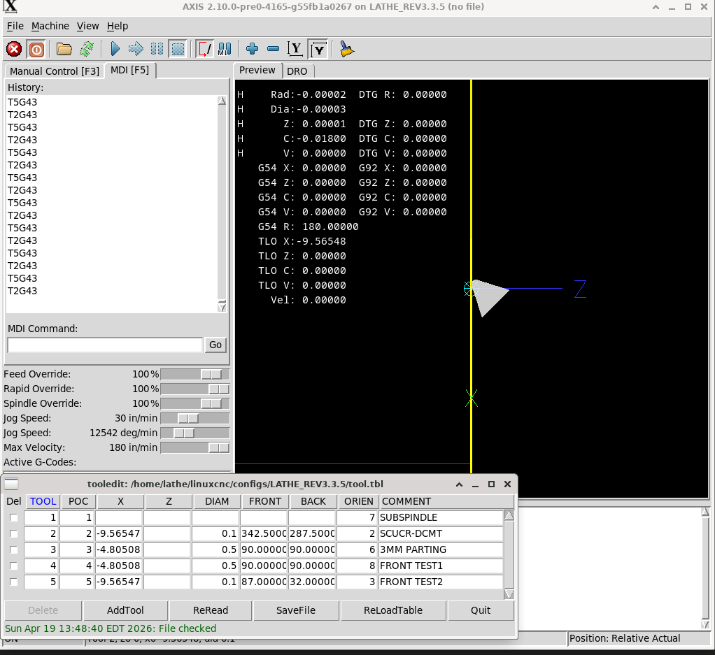

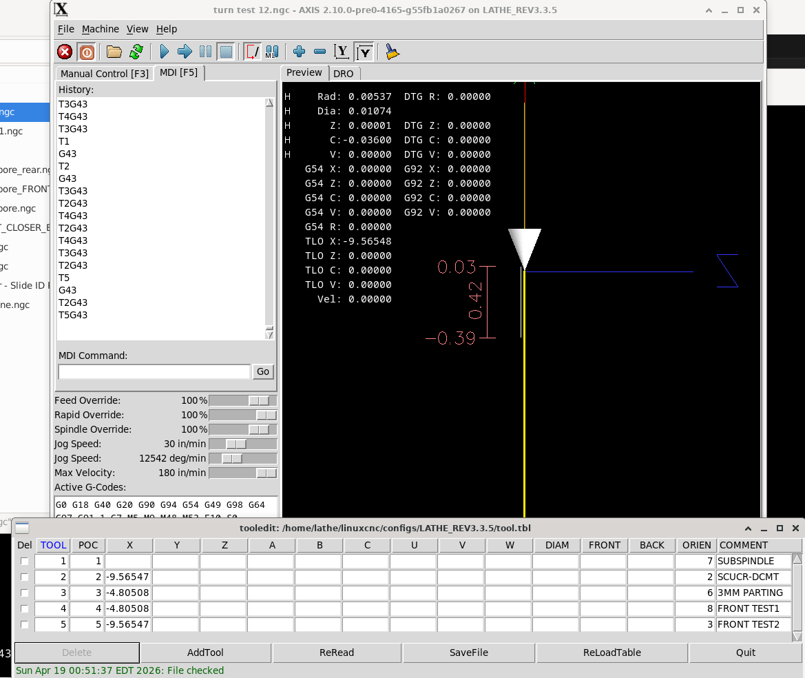

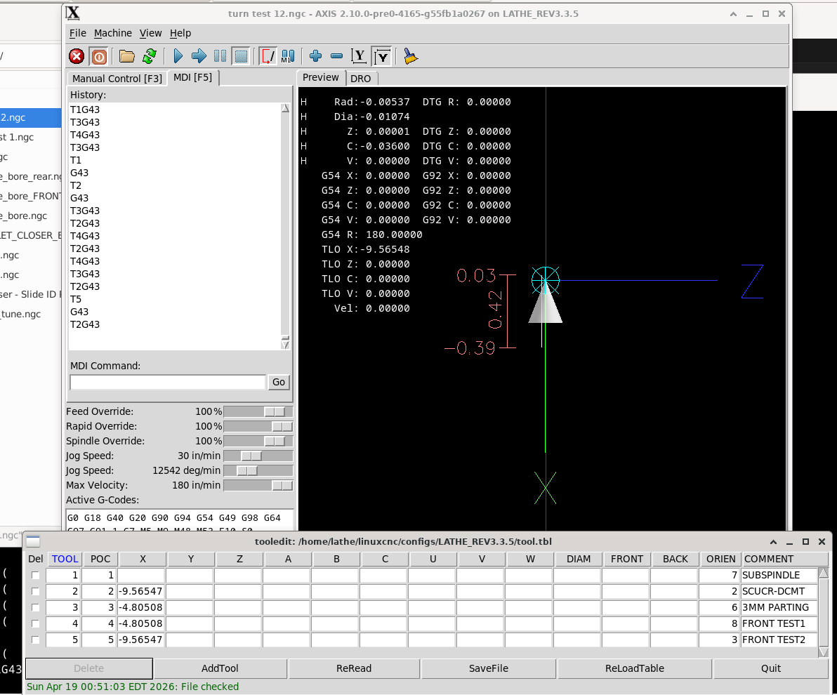

18 Apr 2026 23:54 #345715
by spumco
Replied by spumco on topic REMAP: gang lathe tool orientation
Well, that works nicely with only a minor issue remaining.
Backplot display now follows actual tool orientation, according to the orientation value in the tool table. Had to swap the orientation M-codes; was confused until I remembered I have the configuration set to BACKTOOL in the INI file (X is up/away).
What's a little odd is that rotating the WCS doesn't alter jog direction on the handwheel. X+ moves the table up/away, and X- moves the table down/towards the operator regardless of the WCS flip.
Remaining Issue: Something is off in the remap or toolchange.ngc, because G43 isn't automatically applied despite being in the .ngc file. G43 works in the lathe-fanucy sim, but not on mine for some reason.
Down-facing "normal" tool - T5:
Up-facing "back" tool - T2

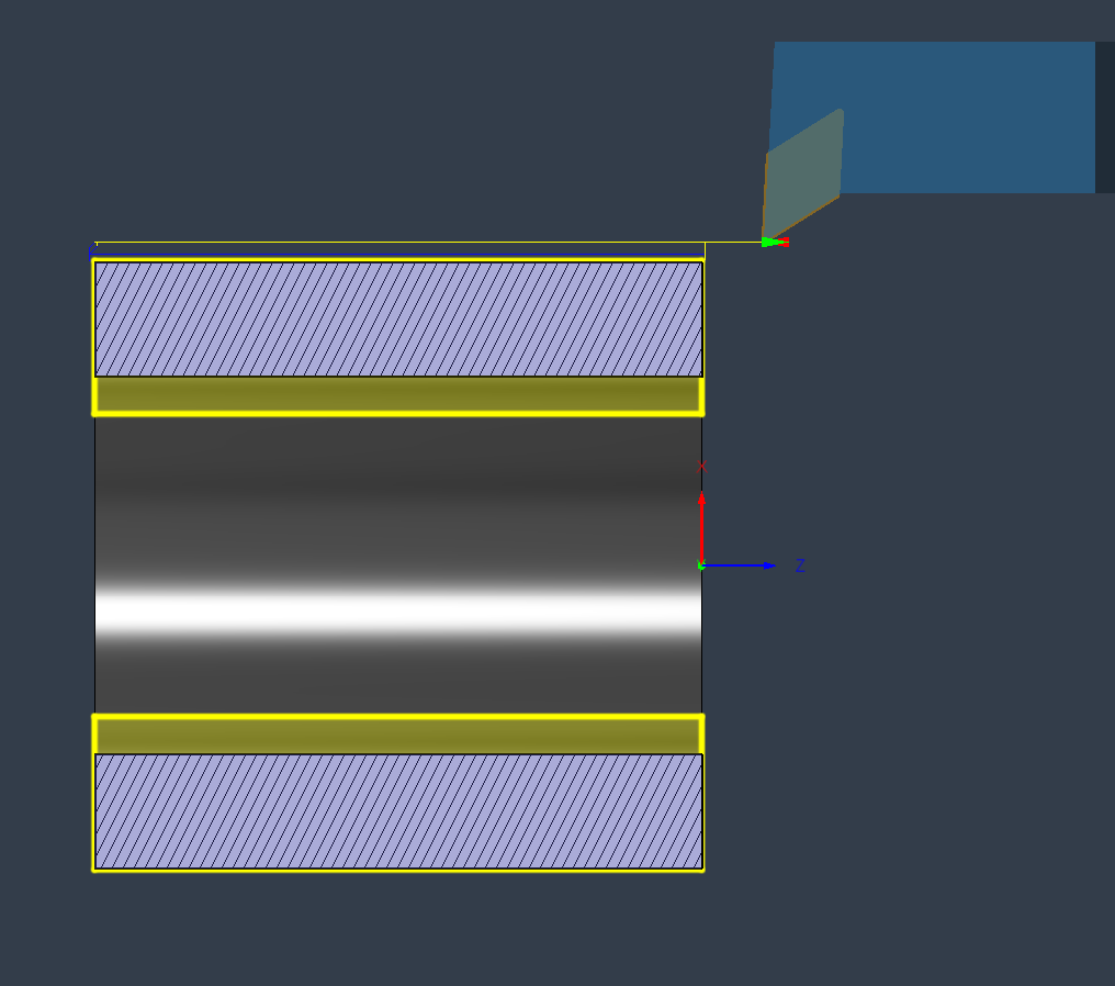

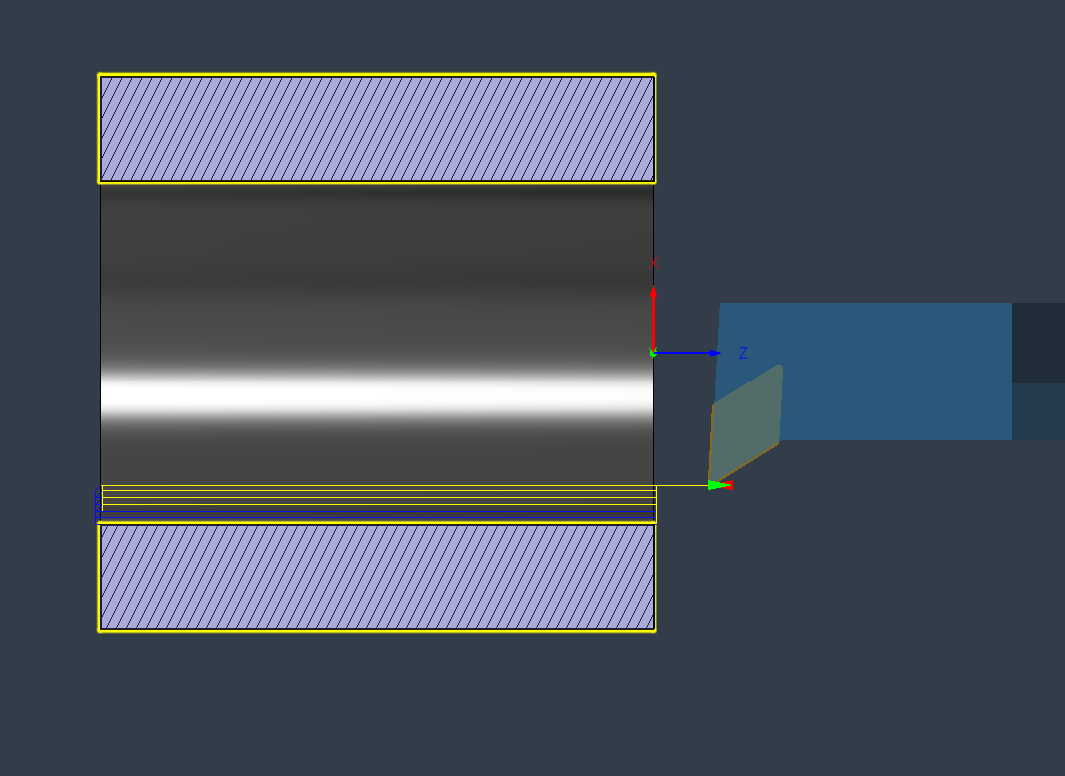

19 Apr 2026 12:54 - 19 Apr 2026 12:57 #345743
by spumco
I set up front and back angles, but it needed diameter to start displaying the inset shape.
However... it's displaying the tool tip past centerline when the tool is at X0. I tried fiddling with the table angles (-87 & -32 vs 342.5 & 287.5) and it didn't make a difference.
Same display issue when the WCS rotation is in effect.
Below photos has tool #2 active.
