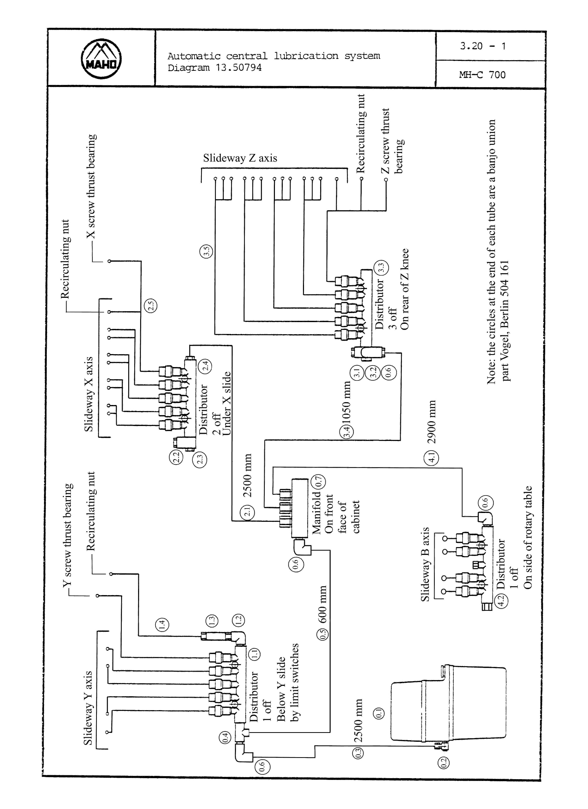

11 Mar 2023 05:04 #266371
by D Jensen
Replied by D Jensen on topic Retrofitting a 1986 Maho MH400E
Thanks Mark for all the fantastic videos and helpful posts. I'm only about half way into this thread.
But I notice queries on the lube system. It may have been covered, but the lube pump doesn't actually meter the amount of oil delivered.
I've modified my lube diagram per my Maho configuration and hopefully can attach it here. Note those final distributors before the slide-ways. Every one has a dose metering piston in it.
So on my machine there are 35 of them!
From a long period of standing some were lightly suck by gooey oil. Also one oil port on the rotary table was gooed.
I'd advise cleaning them all.
Inside you will find a rubber check valve the presses on a central spindle that is very limited in movement. Around that spindle is a metering piston which is spring loaded against the incoming flow.
When the lube pump turns on the check valve opens and pushes the spindle but but keeps its central spindle port blocked.
As pressure builds the metering piston moves back against it's spring until it runs out of travel. I'll call that "cocked".Thus the pressure rises.
When all hit there stops the pump presumably dumps.
My lube unit has a Vogel IGZ 36-2 which is fairly dumb.
When the power is turned on it immediately runs a pump cycle that can't be set otherwise.
When it runs it waits for it's pressure switch to come on. When it does it presumably assumes that all the metering pistons are fully cocked.It then runs on a timer for a further 5 seconds, I presume to be sure to be sure.
Then it stops.
So now the metering pistons don't see pump pressure and their springs push them back to un-cocked. In this mode the check valves re-seat and the oil is delivered through the port in the center spindle.
If you wish to check for blockage simply undo the exit tube from any one of the metering devices until it gets air in it. Then replace it.
Watch as the pump runs and you will see no movement of the air bubble until the pump switches off. Then it moves a measured amount.
All mine deliver the same amount.
If the pump runs for more than one minute without the pressure switch coming on the pump stops and the red fault light comes on.
The IGZ 36-2 only allows the setting of the period between lube cycles. It does have a mode where it will count instead that could be programed by pulses from the traverse movement. Basically it would make more sense for LinuxCNC to do all that instead of the Vogel.
I've put a delay on timer in front of my lube unit so it doesn't turn on for a while. I can change that but it was handy during commissioning so I didn't waste a lot of oil.
BTW. I'm using Gulf & Western Tacway 220 in the lube system. Equivalent to the recommendation. Available in Sydney. Nice tacky feel to it. Works nicely on my lathe bed-way also.
David

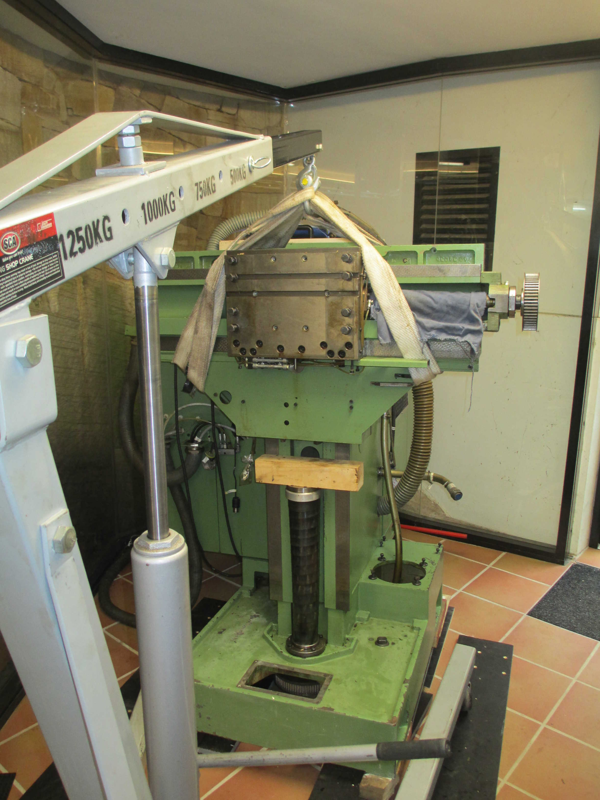

12 Mar 2023 02:30 #266462
by D Jensen
Some more information and words of warning:
Here is and attachment of the Z axis knee being put back on the tower. You can see the aforementioned problem with the lifter feet you have been discussing, of the engine hoist only just clearing the base. But note where that black extension is on the lifter. It is actually forward of the locating pin to get the reach to mate the two assemblies. Not something I would recommend but it shows the limits of these lifters. I was very careful the the load was inside the castor footprint. And the knee is close to the 500kg for that pin load limit also.
The Lifter is from Supa Cheap Auto here in Sydney and is a little heavier than most.
The knee assembly is going on to the original setting of the Z axis slideway wedges, something I wasn't sure it would do. Just a few wiggles and it went on, much to my relief. The screw is fully up and the dunage is in case the knee stuck then suddenly went free if the sling wasn't taking the load.
Note that the Z axis brake motor is missing. So is the drive belt. That means the broken belt ratchet is actually locking the Z axis toothed belt pulley. Be careful that is working as the recirculating ball overruns easily and the the knee will accelerate as it falls and I suspect will hit the base hard enough to smash the castings.
Since then I've found I can hold the knee in place by hands on the screw pulley to inch it up and down a bit. But don't let go! it will get away on you. I had it propped while I fitted the oil supply to the recirculating nut as the banjo is difficult otherwise. But be careful.
A passing note: The original Philips controller had the Y and Z axis swapped from what is now more normal. It confused me a bit as the manual for the Maho had it described that way, but the Heidenhain refit has them with Z as the vertical. It means that the my machine has the servo closing relays in an odd order: X, Z, Y, B. Too much rewiring to change them.
