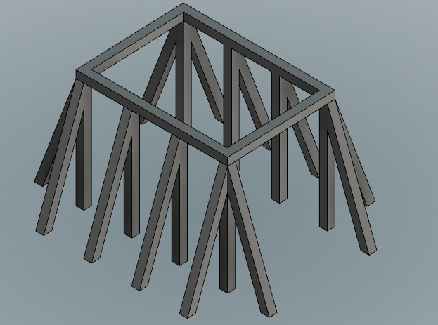

You could retain access while making the structure much stiffer by triangulating to the floor. I admit that it doesn't look especially elegant.

I would add cross members to dampen the vibrations a bit, but that is just me.
