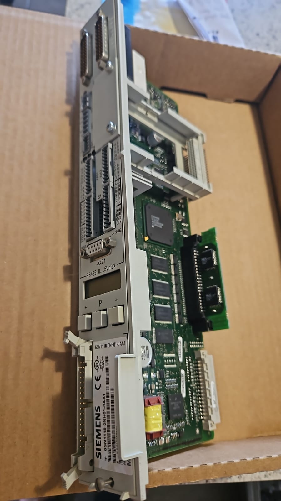

Could you post photos of the SIEMENS 611 controllers?
- Str8jacket
- Posts: 9
- Thank you received: 6
22 Feb 2025 20:30 #322334
by Str8jacket
Replied by Str8jacket on topic Deckel-Maho DMU 50T
