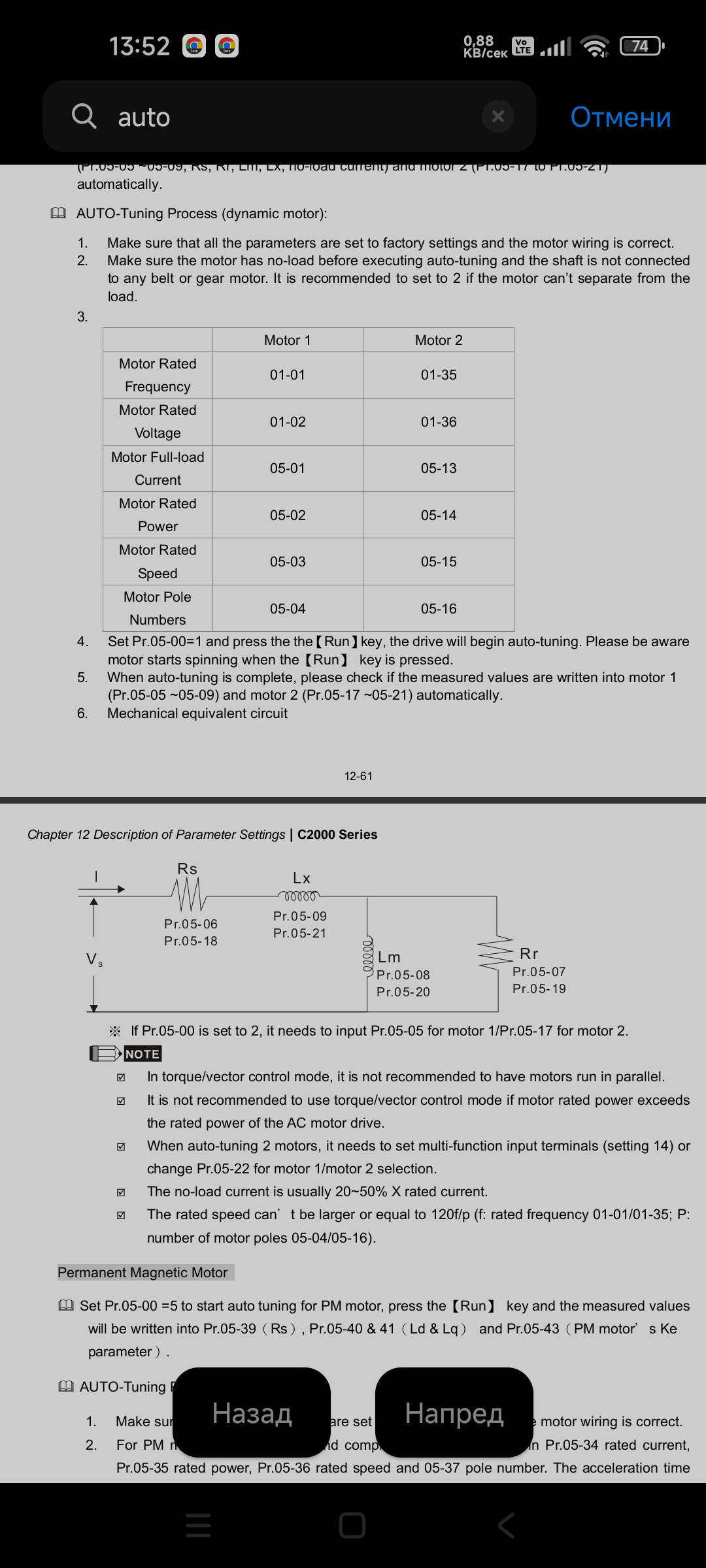

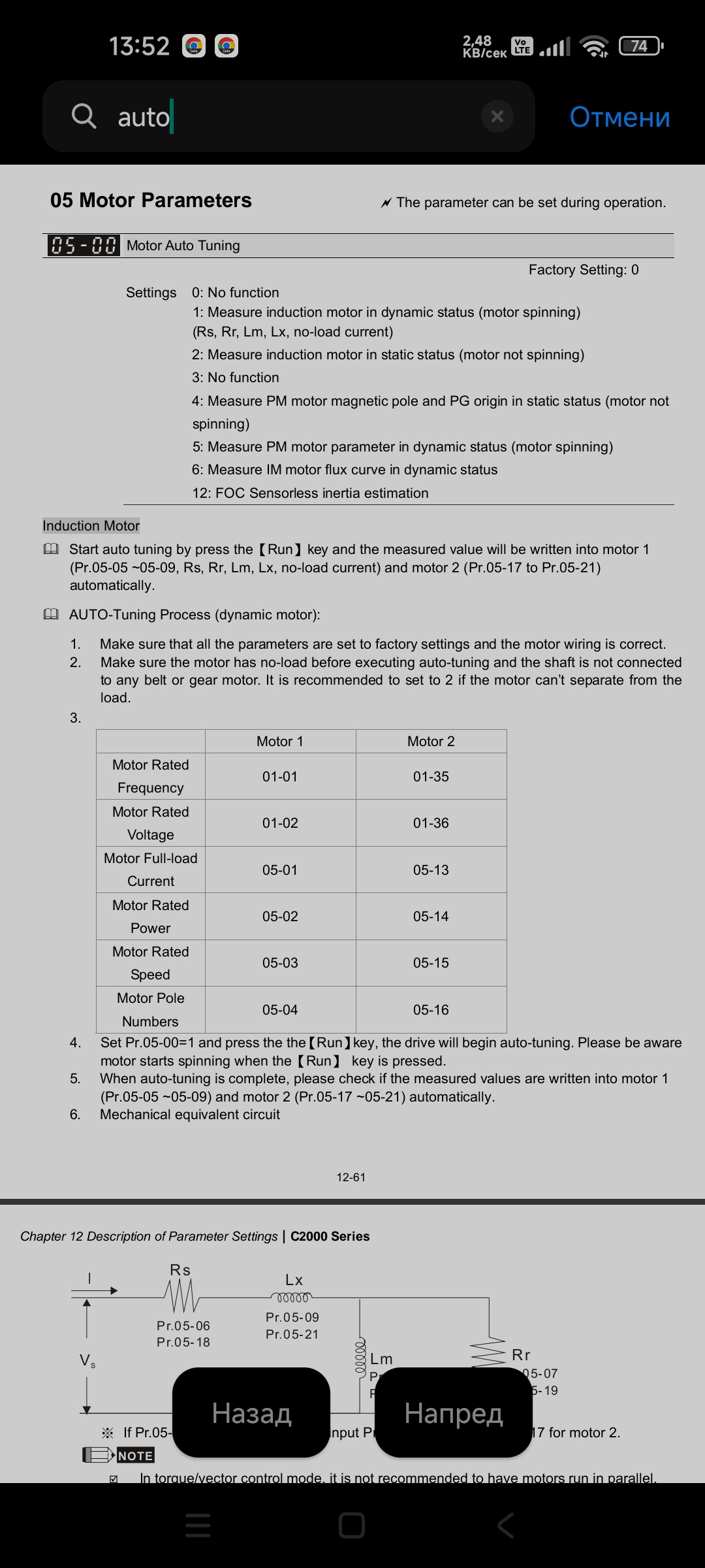

08 Sep 2024 10:57 #309642
by besriworld
Replied by besriworld on topic Fanuc 2S AC spindle motor on Delta C2000+
The following user(s) said Thank You: routerman22
