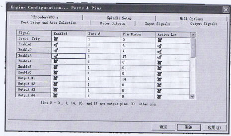

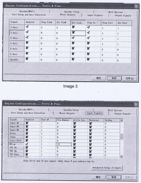

The PC runs ok now... Now the next issue, the Chinese machine vendor only included setup instructions for MACH3
Please help me if I made an error here:

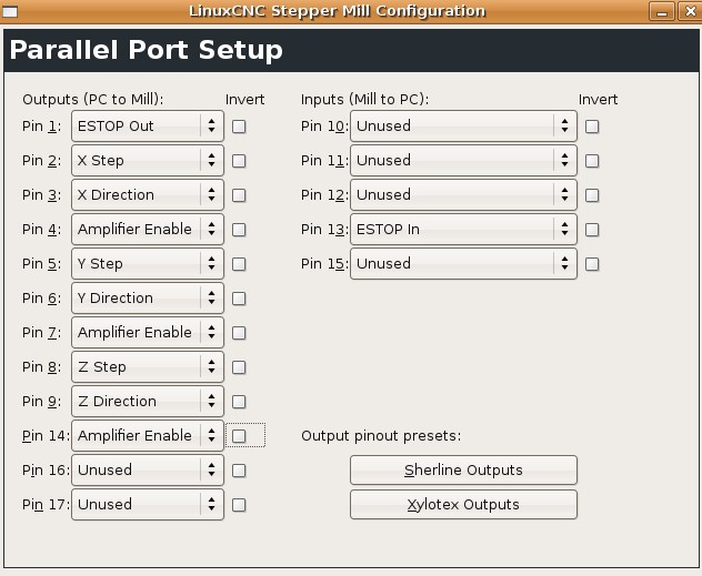

LinuxCNC Screen #1
I just change to mm, and not edit anything else (15000 seems well above my Jitter)
LinuxCNC Screen #2
Pass
LinuxCNC Screen #3
#1 ESTOP Out
#2 X Step
#3 X Dir
#5 Y Step
#6 Y Dir
#8 Z Step
#9 Z Dir
#13 ESTOP in
(pretty clear so far, now...)
#4 enable1
#7 enable2
#17 enable3
What is that in LinuxCNC?

yello wrote:
So, one of the enable lines on the board needed to be inverted? No wonder people have problems with those boards if they are that random.
Just to be clear, do you have the system working OK now?
However, the X-Axis didn't work. When I interchange X and Y then X runs fine. After inverting #4 (Amplifier Enable) it was OK.
