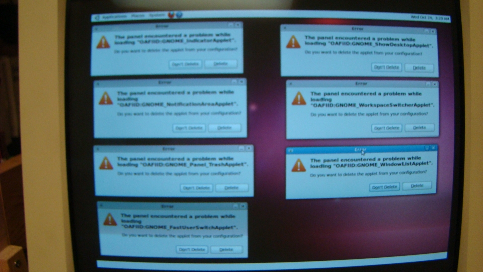

An idea occurred to me, a friend of mine who has more Linux exp than I (I know very little) stated that he tried the emulator (He burned a CD, and used the "Try It" option), and everything worked just fine. he suggested that there may be a hardware problem with my machine. So, I followed his example; I put the CD, booted it, selected the "Try it" option and after a long wait, it came to the desktop with 6 error messages~!!
These are all separate little windows that read similarly. The title of each reads:
The Panel Encountered A Problem While Loading
The individual errors are:
OAFIID:GNOME_IndicatorApplet
OAFIID:GNOME_NotificationAreaApplet
OAFIID:GNOME_Panel_TrashApplet
OAFIID:GNOME_FastUserSwitchApplet
OAFIID:GNOME_WorkspaceSwitchesApplet
OAFIID:GNOME_WindowListApplet
and naturally, at the bottom reads:
"Do you want to delete the applet from your application"
Thoughts? Is something funky regarding my PC? I will scrounge around for another CD, re-download and try it again (I'm using a Windows 7 machine for this)
Thanx -
~S~
24 Oct 2012 08:23 #25733 by ArcEye
Replied by ArcEye on topic Re:Errors with Xylotek controller
Hi
All these errors you have had so far are nothing to do with Linuxcnc, they are GTK / Gnome - Python / GTK / Glade.
You will have to tell us what your computer is and which Ubuntu version of the Live CD you are using.
Some new computers cannot run Ubuntu 10.04, likewise a lot of older ones cannot.
Your monitor looks like CRT so I am guessing an older computer?
regards
24 Oct 2012 11:03 #25736 by BigJohnT
Replied by BigJohnT on topic Re:Errors with Xylotek controller
Download the 8.04 LiveCD and try that.
John
