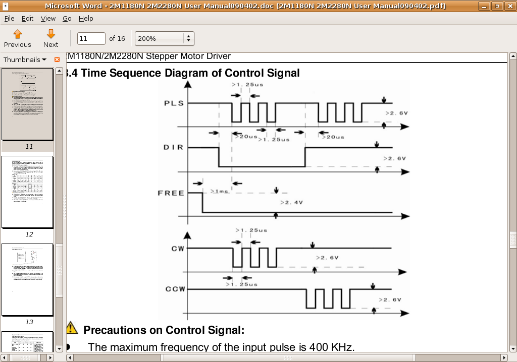

I have entered values for the following based on the picture in my stepper driver data sheet. but not having had to do such a thing before i would be most appreciative if someone could have a look at how i went
Step Time How long the step pulse is "on" in nano seconds.
Step Space Minimum time between step pulses in nano seconds.
Direction Hold How long the direction pin is held after a change of direction in nano seconds.
Direction Setup How long before a direction change after the last step pulse in nano seconds
so this is screen shot from the data sheet

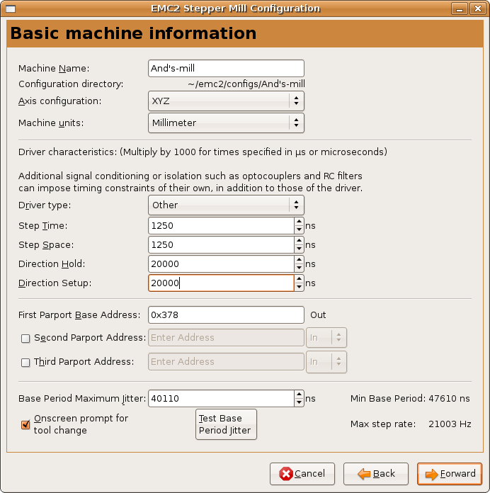

20 Apr 2010 08:04 #2635 by amcc
Replied by amcc on topic Re:Andy's knee mill projct
and these are the values as best i could work out
couldn't work out how to put 2 images in 1 post...
21 Apr 2010 00:03 #2640 by BigJohnT
Replied by BigJohnT on topic Re:Andy's knee mill projct
Looks ok to me...
JT
