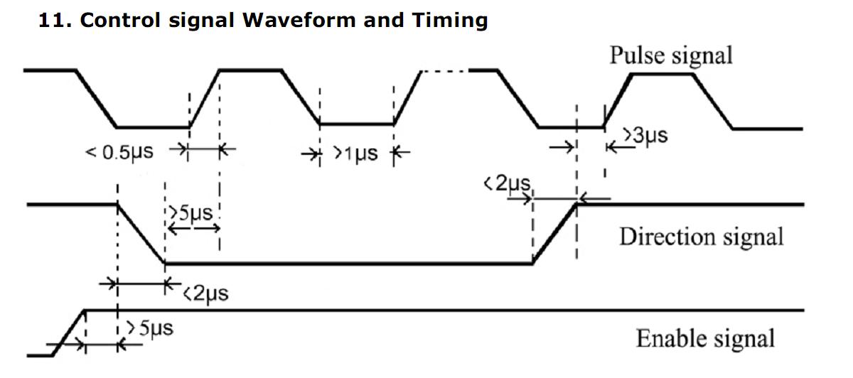

Hey,
I could use some help to find out the correct
Driver Timing Setting
Step Time
Step Space
Direction Hold
Direction Setup
My board is the Haydon DCM8028. Please find attached the
Control signal Waveform and Timing diagram. I have copied
it from the manual.
Would be great if someone could tell me what Timings
I have to use in the settings.
Best Regards
Sandy

05 Jul 2013 19:28 #36332
it looks like 5000nS (5us) will work for all settings.
You could reduce step length to 2000nS (2uS) if you wanted.
Replied by andypugh on topic Driver Timing Settings, how to read Timing Diagram

07 Jul 2013 21:18 #36385
by SandyE
Replied by SandyE on topic Driver Timing Settings, how to read Timing Diagram
Thanks a lot. Works fine with this settings.
