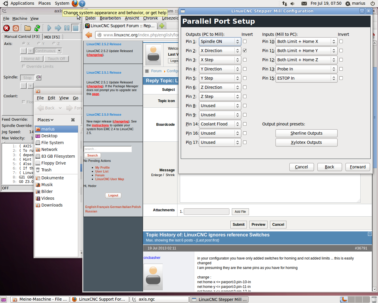

19 Jul 2013 09:11 #36791 by cncbasher
Replied by cncbasher on topic LinuxCNC ignores reference Switches
in your configuraton you have only added switches for homing and not added limits ... this is easily changed
I am presuming they are the same pins as you have for homing
change :
net home-x <= parport.0.pin-10-in
net home-y <= parport.0.pin-11-in
net home-z <= parport.0.pin-12-in
to :
net both-limit-home-x <= parport.0.pin-10-in
net both-limit-home-y <= parport.0.pin-11-in
net both-limit-home-z <= parport.0.pin-12-in
your problem with the motors is nothing more than tuning , the chances are you have them running too fast or your scaling is wrong ,so look at your velocity settings in the ini file
and also your scale and stepping values make sure they are correct

Thanks for your fast reply. It helped but didn't totally solved my problems;)
I changed the lines directly in my .hal-File but then it would ignore the home switches again.
So I changed the paramaters via stepconf-wizard to: Both Limit + Home X
Now the switches aren't ignored anymore (Hurray=)) but:
When I want to Home all axis it starts with the Z-axis. After this one has reached it's switch, LinuxCNC stops with a "joint 0 on limit switch error".
I tried both to invert the X-Switch input and to change the home latch direction, both did not work.
To make it clear: I have only one switch per axis: On the Z axis as upper limit and on X and Y on 0/0 of the machine.
Thanks in advance and best regards=)
