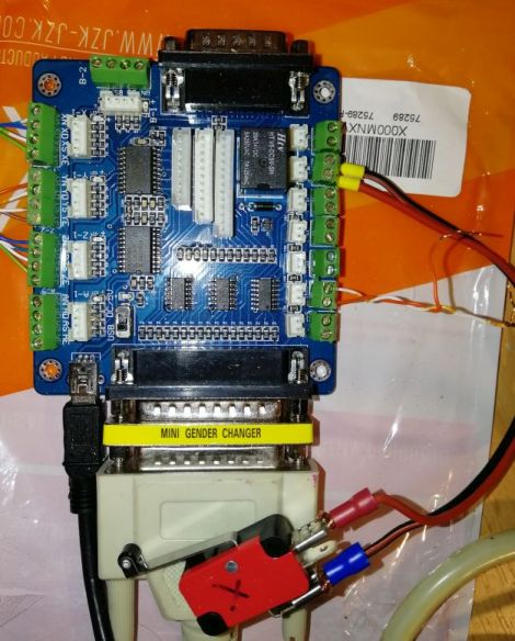

01 Mar 2018 07:55 #106793
by Jocman
Attached there's my BOB (you don't see any pwr led 'cause the system was off).
The 5V are provided by the PC USB, but I tried even with a wall PSU - 1Ah I think it's more then enough: same issue
The parport cable use a gender changer, but I got even a new cable: same issue (all cable's pins checked as working)
The limit switch is wired to P10; the 2 wires on P15 should be the Estop (it was a quick test...)
I asked for support even Zapp Automation (where I got the BOB); they told me I need just a simple switch (as is it....), but they cannot help me 'cause they work only with Mach3 and no LinuxCNC....
Honestly right now I don't remember... (last time I worked on it was las saturday....) when I back home from office I'll check; but I'm pretty sure by now I'm working setting only the Limit, to avoid any mistake

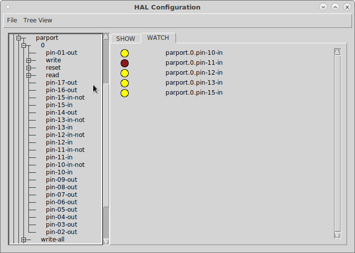

Lets start at the beginning. Have you tried opening Linuxcnc and watching all of your parallel port's input pins with Hal Meters or the watch screen in Hal Configuration while you toggled one of the inputs with a switch?
Do that and take note of which connector toggles which parport hal pin. (Maybe the input pins are not connected to the parallel port pins you think they are.)
Then make the appropriate changes to your config.

02 Mar 2018 07:35 #106833
by Jocman
Replied by Jocman on topic BOB ZP5A-INT and input troubles
I tried even this check, but I got no life signs in HAL Watch for those pins....

This is the BOB I've used. This is about £6 from Banggood or other Chinese suppliers. It needs 12v for the inputs to work. It might be worth getting one just to check.

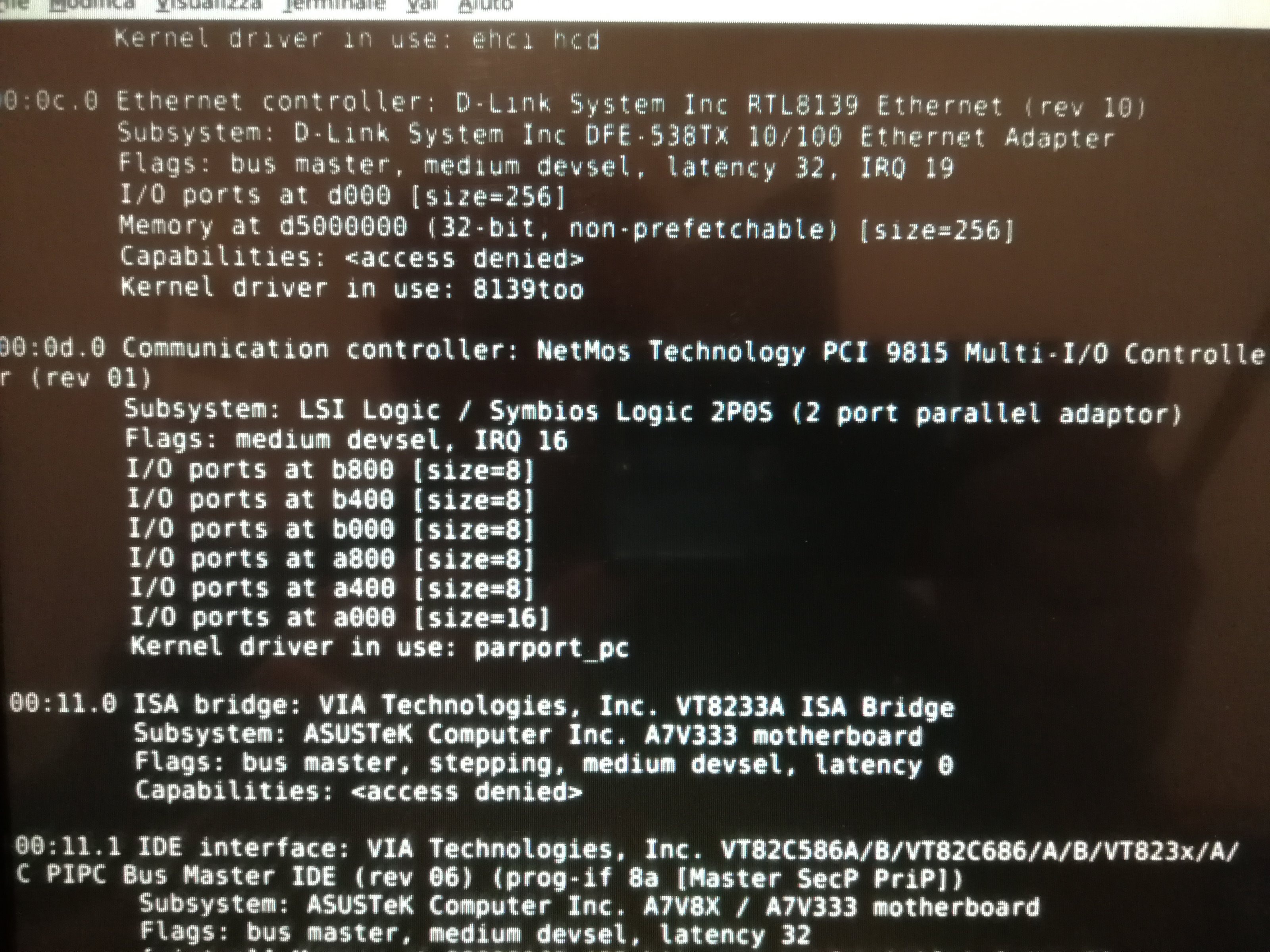

03 Mar 2018 07:37 #106873
by Jocman
I got 2 of them (one from amazon and one from china - still waiting for the one from china).
I'll check it during the weekend, see what happens....
My parport bios setting is EPP (reading here and there, I found EPP should be the right setting, but it's most possibly I misunderstood, so tonight I'll try by changing it to SPP - or the others too)
Last night I did several tries....
1) Installed and external PCI parport (NetMos based) with 2 more partport (but only the one onboard, I didn't plug the wired one by now). In the bios I found a second (?) parport address (278) now. By listing in debian (lspci -v) I found 6 new addresses (see attachment). By editing my HAL file manually adding the second port with the address B800 (the first in the list), in the hal monitor I can see the second parport. I connected the BOB on the second directly but no change (honestly, I'm pretty sure I made something wrong...)
2) disabled in the bios the onboard parport, using only the pci. Same issue.
3) enabling again the onboard one, now the bios report me even a 3 (?) address 3BC (now the list is 378H,278H,3BCH....)
Then I gave up, as my soulmate was staring me with no honey in the eyes (I don't know if it sounds good in english, but "the honey in the eyes" in italian means "plenty of love").
Optimistically, I hope it's only a software issue (even if it drives my crazy...)....

05 Mar 2018 09:26 #106943
by Jocman
Well....
It's all working......
The solution was as raglanlittlejohn suggested: wire both power inputs
The chinese one worked very fine.
Then I tried with my ZP5A, by wiring both the power inputs, and it finally works fine.
What make me p***ed off is that on both BOB's user manuals there's nothing about that....
ZP5 manual reports the BOB as working OR via USB power OR via external power (switching the selector on the board).
None of both of them report something like "Note, if you want to use the inputs you MUST connect BOTH power inputs"....
By the way....
