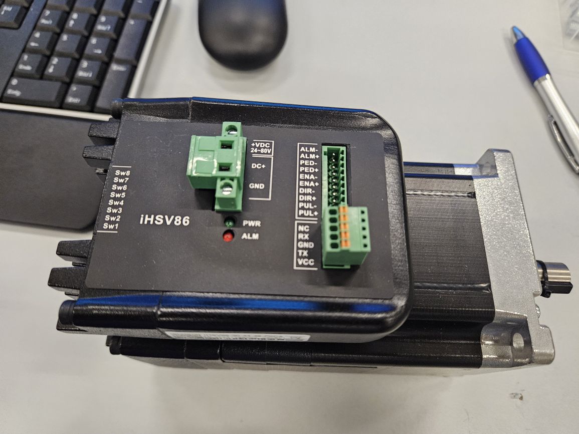

Earlier, I have a servomotor from JMC : model ihsv86. its Pul and Dir signals are wired to the parallel port pin 4 and 5 respectively. the motor runs as A axis in the current setup. However, now i want to use the servomotor as a spindle. and my X axis to be a tool table linear slide.

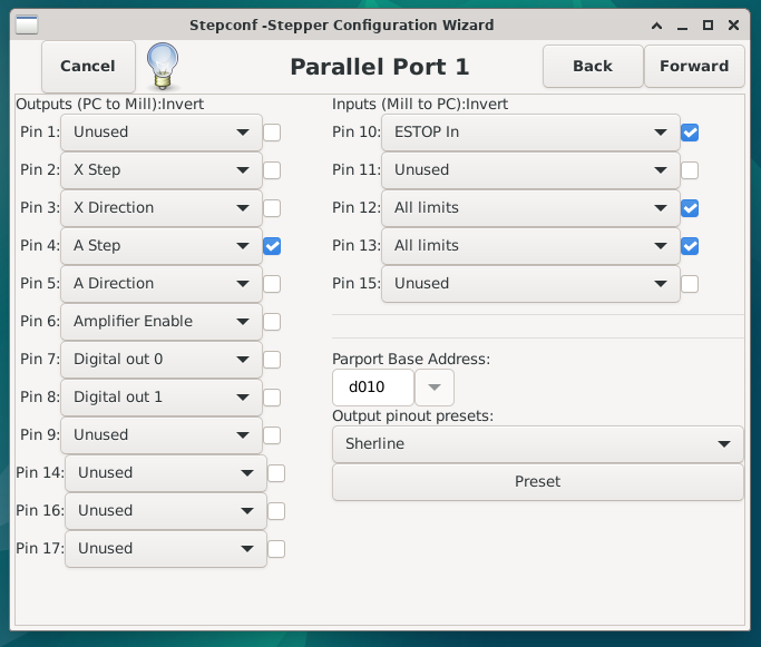

18 Nov 2024 15:27 #314801 by sk_linuxcnc
Okay. So. As you can see, i have the servomotor's Step signal connected to pin 4 and Pulse signal connected to pin 5 of my parallel port.
What should i configure these two pins as in the step config?
Where should i write stepgen and how?
How can i enable this motor? The enable of the two motors are on a common pin 6 as you can see in the image
18 Nov 2024 17:05 #314808 by PCW
stepconf doesn't know how to setup a step/dir spindle so I would
setup an unused axis for the spindle, and then edit the hal/ini files.
If you do that and post the hal/ini files, I can give you some direction
in what needs to be done.

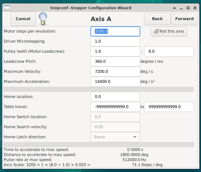

20 Nov 2024 09:39 #314919 by sk_linuxcnc
how should i attain the maximum possible rotational speed on my spindle?
my current settings are:
[SPINDLE_0]
SCALE = 6400
MAX_VELOCITY = 20000.0
MAX_ACCELERATION = 40000
STEPGEN_MAXVEL = 25000.00
STEPGEN_MAXACCEL = 40000
DIRSETUP = 10000
DIRHOLD = 10000
STEPLEN = 5000
STEPSPACE = 5000
STEP_SCALE = 6400
the spindle motor is set to 800 Pulses/rev
when i configure the motor as the axis, the fastest possible speed is apparently a bit higher than i can achieve when configured as a spindle

20 Nov 2024 12:00 #314931 by PCW
The limit will likely be the rate at which steps can be generated by the parallel port
If you set the stepgen velocity with RPM and you have 800 steps/turn the step scale should
be 800/60 = 13.3333.  With a 55 usec base period and 800 steps per turn, this limits you to 1350 RPM
The following user(s) said Thank You: sk_linuxcnc
