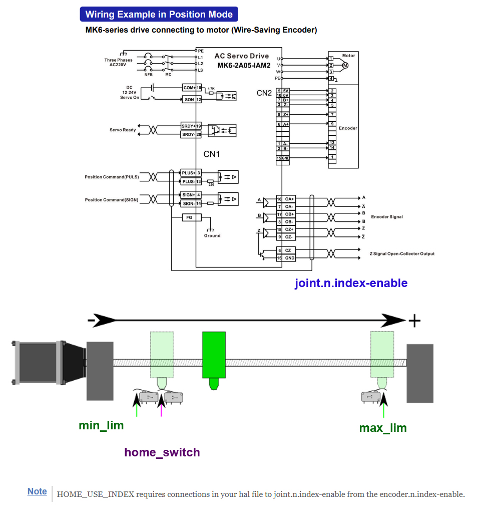

Hello everyone. I haven't been to the forum for a long time.
Need help and complete clarity in using HOME_INDEX = YES and STEP/DIR
When I upgraded old machines that used analog control and encoder feedback, this issue was not there. In the topic Homing index andypugh writes and gives a link to the source file homing.c. I asked chatGPT to analyze this file. And the chat says that indeed to reset the HOME_INDEX search flag you need a signal from encoder.n.index-enable. That is, linuxcnc does not support the function of searching for 0 labels in step/dir mode.
Most of the new hobby machines that I and my friends are currently assembling use servos in step/dir mode and without a closed loop. Since for a hobby, the driver <-> motor with encoder connection is enough. But home_switch gives a small but noticeable error. Therefore, such a request will appear more and more often.
On my 7i92 there are no free 9 pins for 3 x A B Z encoders. And almost all servo drivers have a simple transistor output that duplicates the 0 encoder mark.
Are there any "macros" or "tricks" to get around this problem?
Is it possible to add this functionality to the homing.c source?
Thx for help.

If your 7i92 doesn't have a free input for the Z signal, that's too bad. I'd recommend upgrading so you have more inputs. Alternatively, you can set HOME_USE_INDEX = No, and then LinuxCNC will use the home switch for reference. However, this is less accurate.

To say you have open loop is not correct. your encoder output should be fully wired in so you do have a feedback loop. Some machines have a dual feedback loop with the motor encoder configured in velocity mode inner loop and optional linear scales configured in position mode as the outer loop.
There are many closed loop stepper motors with encoders and a few also have an index signal. Usually the dual feedback system connects the motor encoder velocity feedback to the drive and the position feedback to linuxcnc.
I have never had drives with index marks but my uderstanding is that linuxcnc can search for a home switch, then move to the nearest index pulse before completing homing. Ethercat drives that home internally are different animal altogether

Mesa Hostmot2 supports homing to index on step/dir systems.
It requires firmware that supports step/dir Index (normally
such firmware has "SDI" in it's name). It also requires one free
input per step/dir channel for the index signal.
This allows homing to index and spindle synchronized motion on
step/dir systems without encoder feedback to LinuxCNC.

Step/Dir index support with Mesa hardware does not need any
programming, just the correct firmware and a minor hal change:
Replacing the encoder index enable with the stepgen index enable.
It's likely possible to do this with programming but that has the disadvantage
of having an index detection uncertainly of a thread period.
Does your current setup have inputs available for index inputs?

A quick note to make it easier to find:
Instead of
“hm2_board.0.encoder.1.index-enable”
Use
“hm2_board.0.stepgen.1.index-enable”
