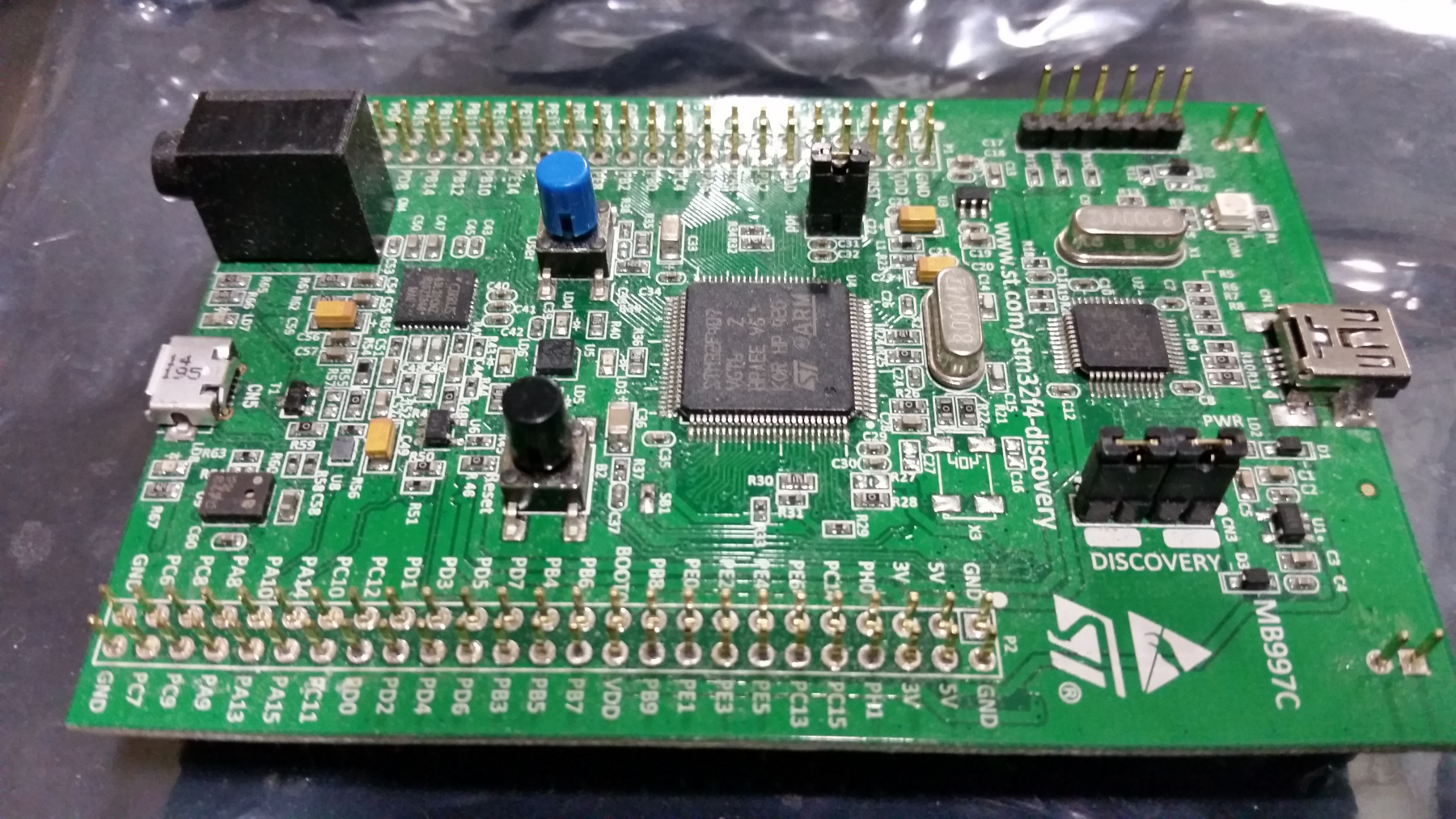

More source examples for the W5500
www.simplerobot.net/2018/06/rpi-ethercat-master-picat.html
Already works with LCNC forum.linuxcnc.org/ethercat/42048-notes-...at-on-raspberry-pi-4
More nice info www.hackster.io/esmacat/easy-way-to-buil...ough-ethercat-285811
github.com/XiaojiaoChen/F7_Ethercat_RTOS

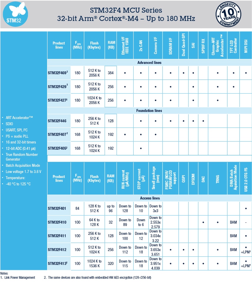

Trying to do a port to the 446 because there are some pretty nice boards with the 446. I had to (get a new computer thats 64bit(I hate windows10 so much)) change a few files it looks like a lot is stripped down for just 407, almost got it to compile (I think) but I am now stuck, if you have any insight you can provide, that would be appreciated. And your patience is appreciated.
I dont know what to do with the RNG/RTC stuff, like where to define or disable, and probably the build offset needs to change but im not finding one in the marlin source for it.
edit, working great on the skr2 so far, thanks
Building project firmware (OCTOPUSV1.1, ARMC6)

DOesnt come out of estop and noting in the terminal
In the marlin ini file for stm32f4, the octopus doesnt have a bootloader offset
do i just remove the bootlaoderoffset from custom targets?
I cant get the main repos to compile for all 3 targets , only the stm32 repo i can get to compile the skr2
