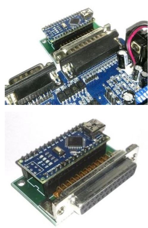

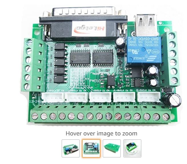

That's kinda what I am doing.
I use a lpc chip hooked into one of those break out boards for added protection and the use of the pwm to 0-10v and relay.
I know before the virus I was able to pick those board up from Ali for around 3$
- Bari
- Posts: 639
- Thank you received: 234
13 Sep 2021 17:51 #220477
by Bari
Replied by Bari on topic Remora - Rpi Software Stepping Using External Microcontroller via SPI
Might be an option for those IF the optos switch fast enough and you can deal with the lack of 0V for the spindle control on many versions of those. It would be nice to find a source for these that have the good parts vs the crappy slow optos. My interests in a STM32 board would include encoder feedback.
