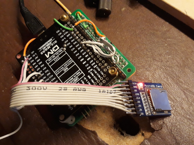

19 Aug 2021 22:13 #218183
by scotta
Replied by scotta on topic Remora - Rpi Software Stepping Using External Microcontroller via SPI
Hi, both software encoder counters and the LPC1768 QEI hardware encoder have modules in Remora. Theoretically we can create a module for any of the available hardware on the microcontroller.
I've got an STM32F407 sitting beside me, it's got even more peripheral options. Just need to get mbed working with it...

we should create a github repo. Which version of OS Mbed are you using ? (or trying to use)
Replied by gtt38 on topic Remora - Rpi Software Stepping Using External Microcontroller via SPI
I just received my SKR 2 so now i can help you.Hi, both software encoder counters and the LPC1768 QEI hardware encoder have modules in Remora. Theoretically we can create a module for any of the available hardware on the microcontroller.
Last edit: 22 Aug 2021 16:17 by gtt38.
- scotta
- Posts: 959
- Thank you received: 489
24 Aug 2021 06:06 #218587
by scotta
Any help getting the "Hello world" working would be appreciated.
Hi, I'm using OS5 and now have a custom target working when flashing with an ST-Link to the base address of 0x08000000. When re-flashing the standard bootloader (take an image of the MCU before blowing it away... yes I had to search hi and low for a copy on line), and changing the target.mbed_app_start to 0x08008000, which is the bootloader jump. The app fails... This may be due to the VECT_TAB offset but still trying to figure this out. Once I have a working "hello world" loading from SD card, I can move on to the SPI port. The rest should be straight forward using the work that Rommel has already done.

24 Aug 2021 21:44 - 25 Aug 2021 21:57 #218644
by mhel
Replied by mhel on topic Remora - Rpi Software Stepping Using External Microcontroller via SPI
Hi Scott,
This might be of interest.
github.com/GadgetAngel/BTT_SKR_13_14_14T...R%20V2.0%20(SKR%202)
I managed to get the bootloader working.
Apparently you also have to change the VECT_TAB_OFFSET.
#define VECT_TAB_OFFSET 0x8000 /*!< Vector Table base offset field.
This value must be a multiple of 0x200. */
Edit this is my linker memory config:
/* Specify the memory areas */
MEMORY
FLASH (rx) : ORIGIN = 0x08008000, LENGTH = 1024K-32K
RAM (xrw) : ORIGIN = 0x20000000, LENGTH = 192K
MEMORY_B1 (rx) : ORIGIN = 0x60000000, LENGTH = 0K
It took me a while and a whole lot of ducking (duckduckgo user since 10yrs).
The VEC_TAB_OFFSET is what make it worked.
Last edit: 25 Aug 2021 21:57 by mhel. Reason: grammar check
