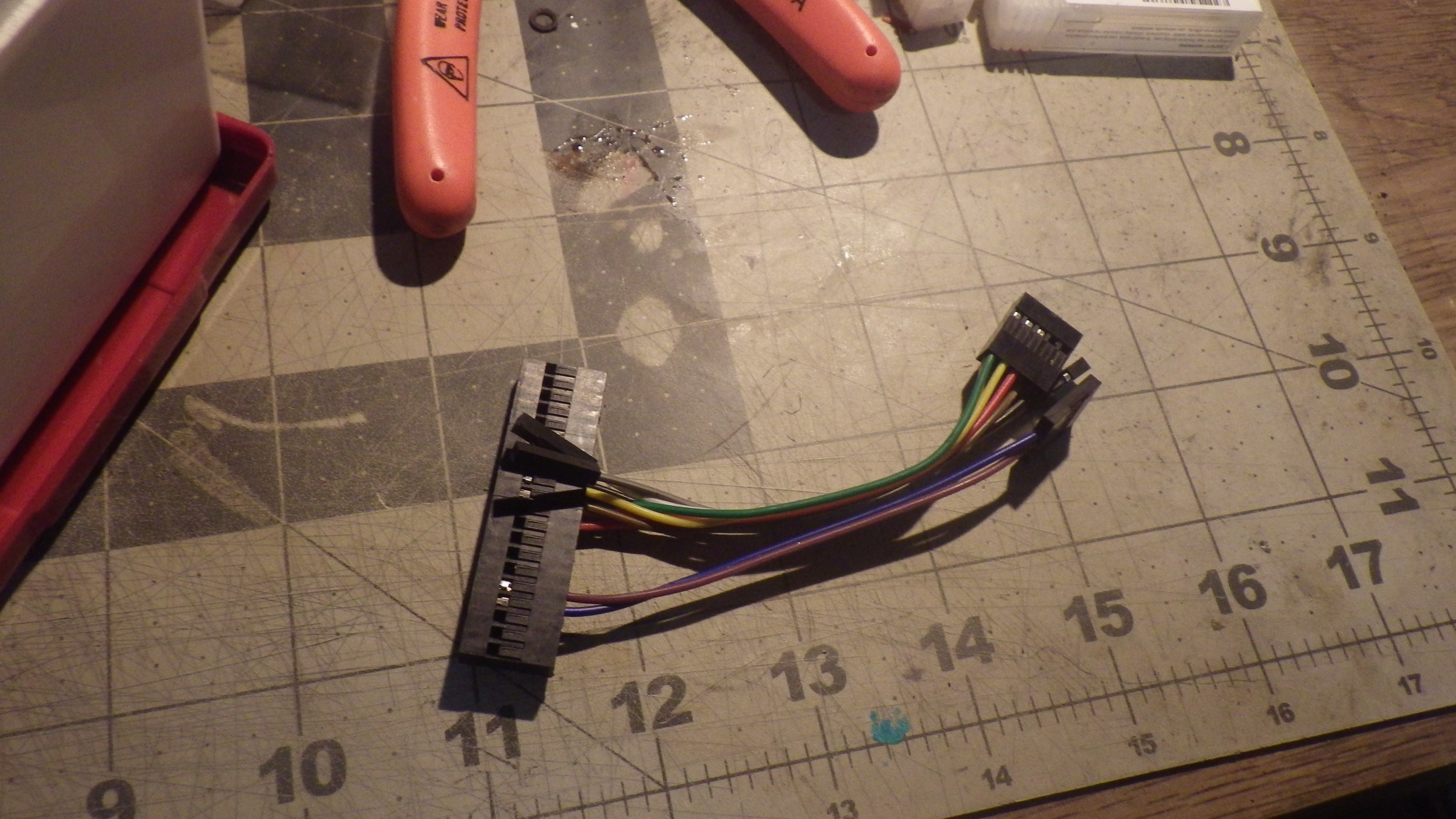

08 Aug 2021 05:20 #217176
by cakeslob
but anyways, back to remora
heres my fast and dirty setup . no fancy pcb but my bitchin all-purpose utilitarian cable, now with unnecessary length! colour coded as per the manual to minimize those looming wiring errors! Tired of short circuits? All the connectors on The Regular Ass Cable are insulated to save you from your self! All the flexibility of a cable, while still maintaining the freedom to plug it in backwards(its a feature)! Are you so lazy that crimping is the only thing between you and success? You can buy pre-crimped for mere pennies per wire!
Replied by cakeslob on topic Remora - Rpi Software Stepping Using External Microcontroller via SPI
but its an fpga, so you could just build a gpu. but yeah good point i didnt think of that. looks like theres one xilinx zynq that has a mali400 on it . i mean i dont need fancy graphics, the fanuc i use everyday doesnt have any fancu graphics, but i dont not want fancy graphicsIf they only had a GPU
