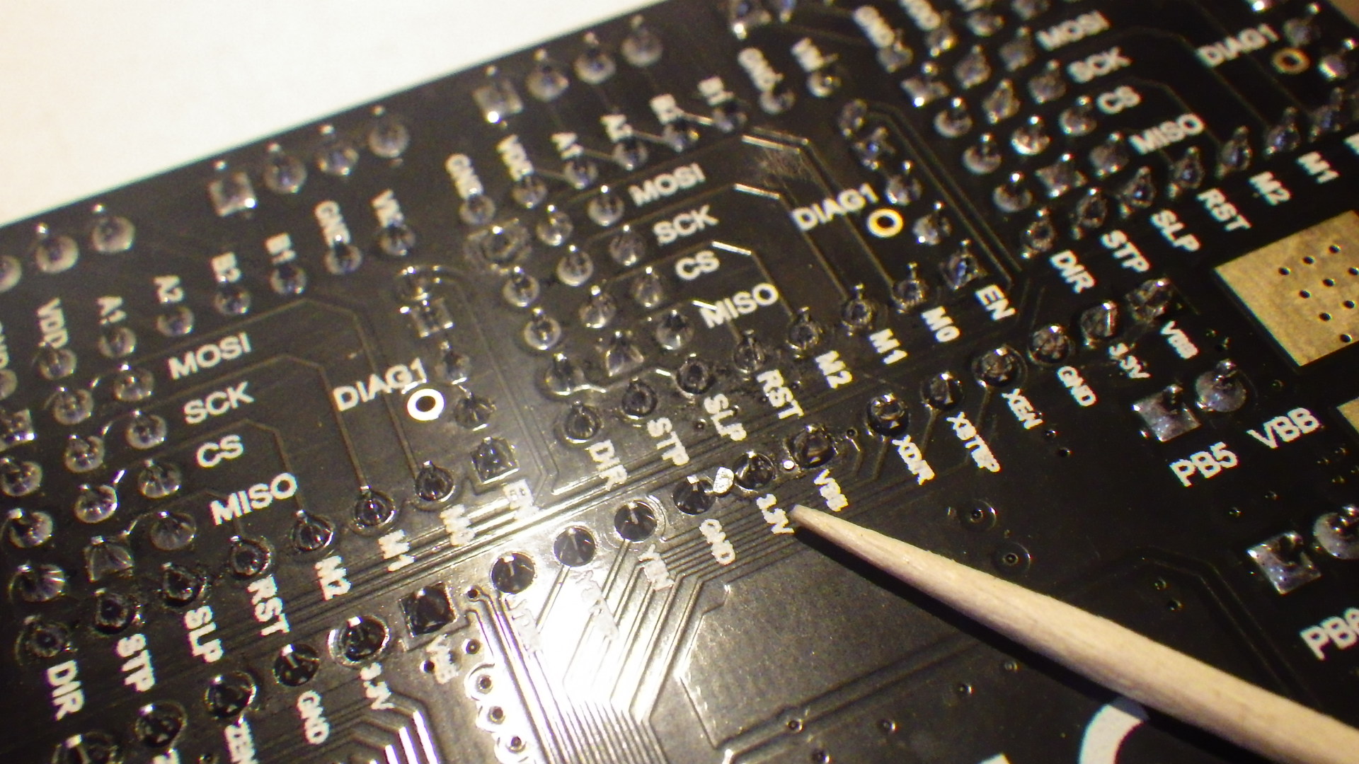

Ok, the rx and tx are on the same TFT connector as the 1.4 except flipped 180 degrees, PB_4 is going to HE1_pwm > HE1_MOSFET > D13, and PC_13 is going to MOT_POWER which turns on the VMOT (and VBB?)via the U5 opto and the Q1 mosfet correct? How does it provide feedback for the anti driver reverse to work? Something to do with Q2 mosfet? What a handy feature (lol sorry).
I compiled it using the online compiler , and the bin was 40.3kb, is this an acceptable way to do it or do I need to install mbed ide to have it compile for os5? I didnt see anything to selecting versions with online compiler. It sent a few deprecated function flags while compiling but thats it. Im sorry if this question was answered earlier on.
Second, is this being loaded from ST-LINK, DFU, or via SD card?
Thank you for your patience, and hard work.
I will have to provide my own QC03 sticker after I clear all these stray solder balls from the board myself.

29 Aug 2021 22:05 #219129 by scotta
I used Mbed studio and it actually worked with the ST-Link in debug mode as well. Didn't test when using the standard SD bootloader though.
When trying to get the blinky to work I had to figure out that enable circuit as well. I think it would be useful for drivers that we can talk to like the TMC2209's. No comms, don't enable the drivers. For a dumb driver I'll need to look at the circuit diagram / Marlin code to understand what checks they are doing before motor enable.
When we get the port going on the STM32 it will open up a heap of board options. We'll need to port to the STM32F1 series as well.
