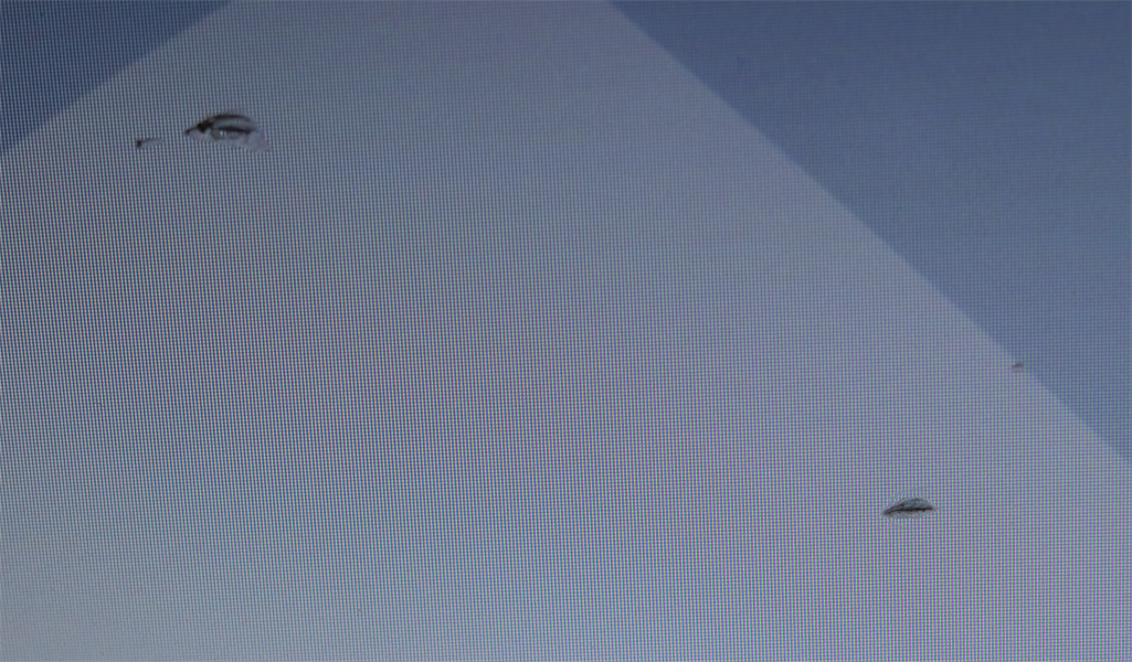

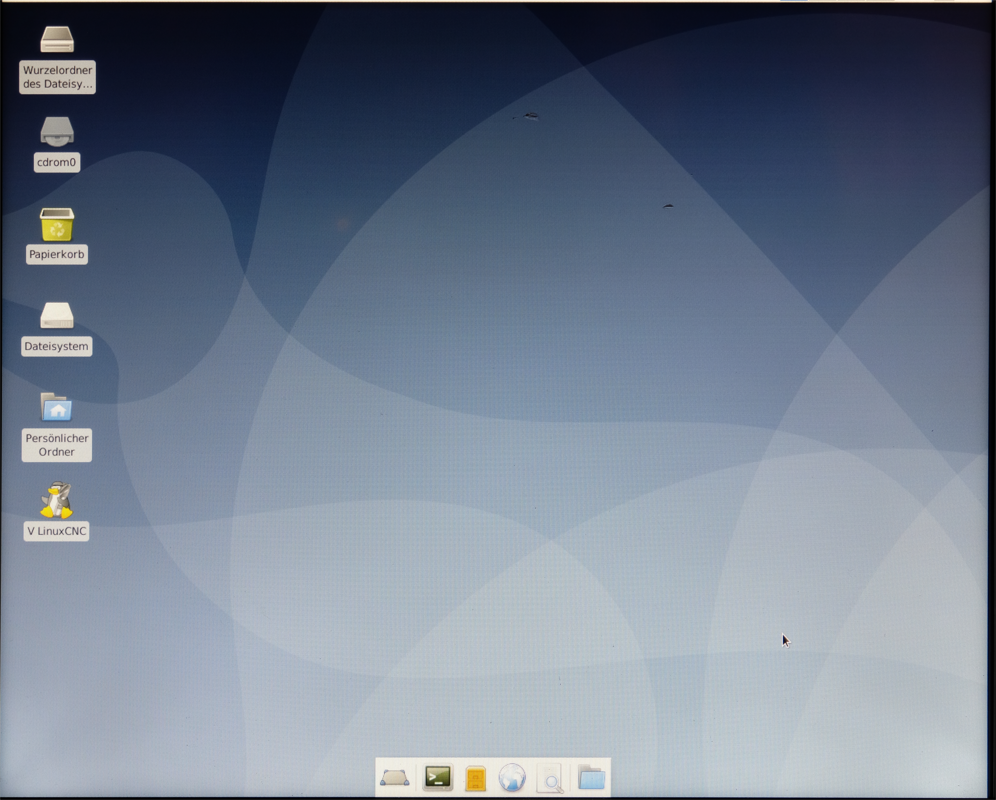

Before I had a Faytech FT17TMB - 17" Touch-Screen. That was about 2015. Later it got replaced by a Dell U2415 24", 1920 x 1200, no touchscreen.
If someone in switzerland is interested in the Faytech Monitor, i could give it away, as it is collecting dust in the storage room.
Just recognized there is some small damage on the surface, so the device will be free, to pickup. The evfilter driver for linux from Faytech download worked on todays function test. As the stand is disapeared, Vesa 100 mounting.

holy shit you can see the chips in the screenshot
