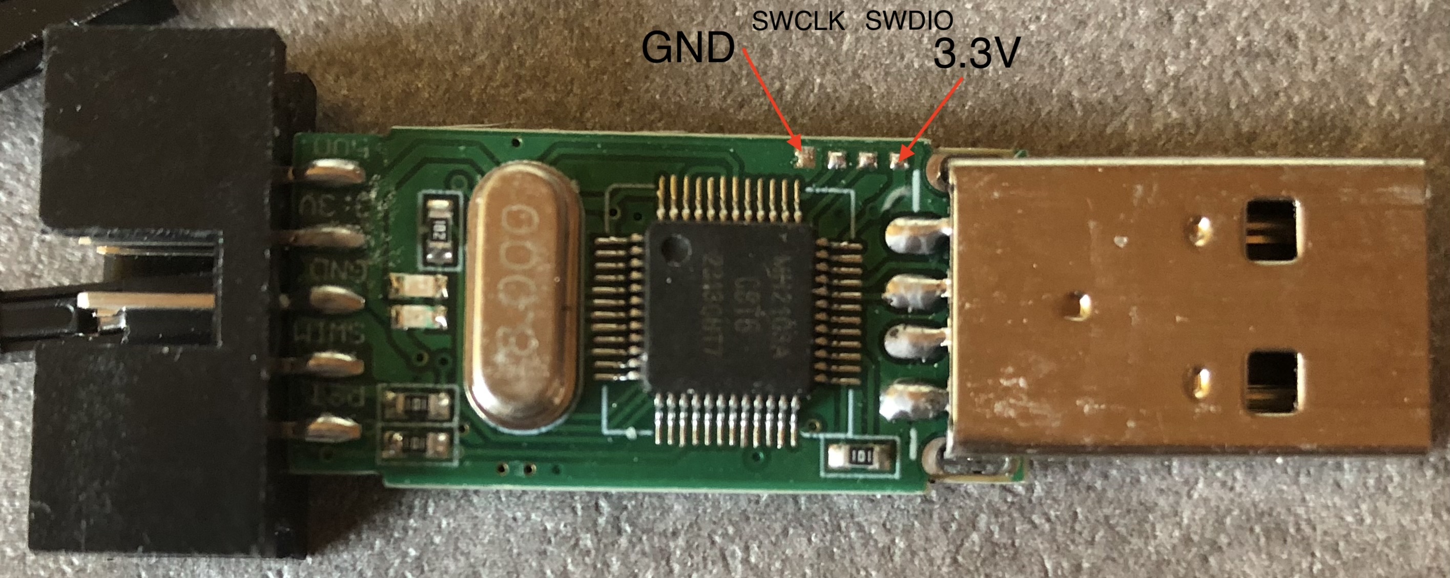

29 Mar 2024 11:21 - 29 Mar 2024 11:33 #297093 by peterling
Replied by peterling on topic Remora - ethernet NVEM / EC300 / EC500 cnc board
Hallo  oficinerobotica,
you said it is possible to flash a New EC500 with a unmodified ST Link V2 adapter? how does this work? At the moment I have 2 ST Link V2 in front of me and have problems to flash one of them to CMSIS-DAP because I don't know how to connect them. I can't locate the SWDIO and SWCLK pins on the PCB.
I have a pin layout of the MH2103A, but I don't know the right names of the pins
When it is flashed to CMSIS-DAP it should be easy to flash the EC500. But how to do the flashing without CMSIS-DAP? Which software did you use?
Last edit: 29 Mar 2024 11:33 by peterling. Reason: insert picture
29 Mar 2024 11:31 #297095 by Cold Turkey
Replied by Cold Turkey on topic Remora - ethernet NVEM / EC300 / EC500 cnc board
Read the guide at the top of page 165. It explains in detail how to use a standard STLINK
Pyocd is the software being used. Look up a pin out picture for your STLINK You want GND, SWCLK and SWDIO (they may be marked slightly differently depending on manufacturer)
The pins on the EC500 are clearly marked.
