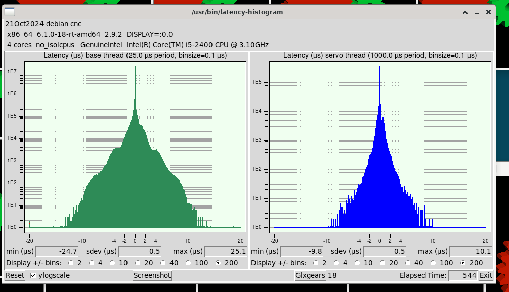

Hello everyone,
after a long break, I have now returned to the problem.
Specifically, I bought a Lenovo ThinkCentre M91p i5 2400 with 8GB RAM and 128GB Intenso SSD. Very reasonably priced at under 30€ including shipping.
I would recommend this to anyone who has a PC with poor performance. The old PC cost me a lot of nerves and also took away some of my enthusiasm for the project.
This gives me much better values in the latency test. The values were already significantly better without any optimizations!
I have now also bought a Mesa 7i96s to control it. It hurts once, but with it I can build a clean cabling right from the start without soldering cables etc.
The next steps are now to set up the controller on the desk. There are bound to be a lot of new questions about this.
Erwin
Erwin
