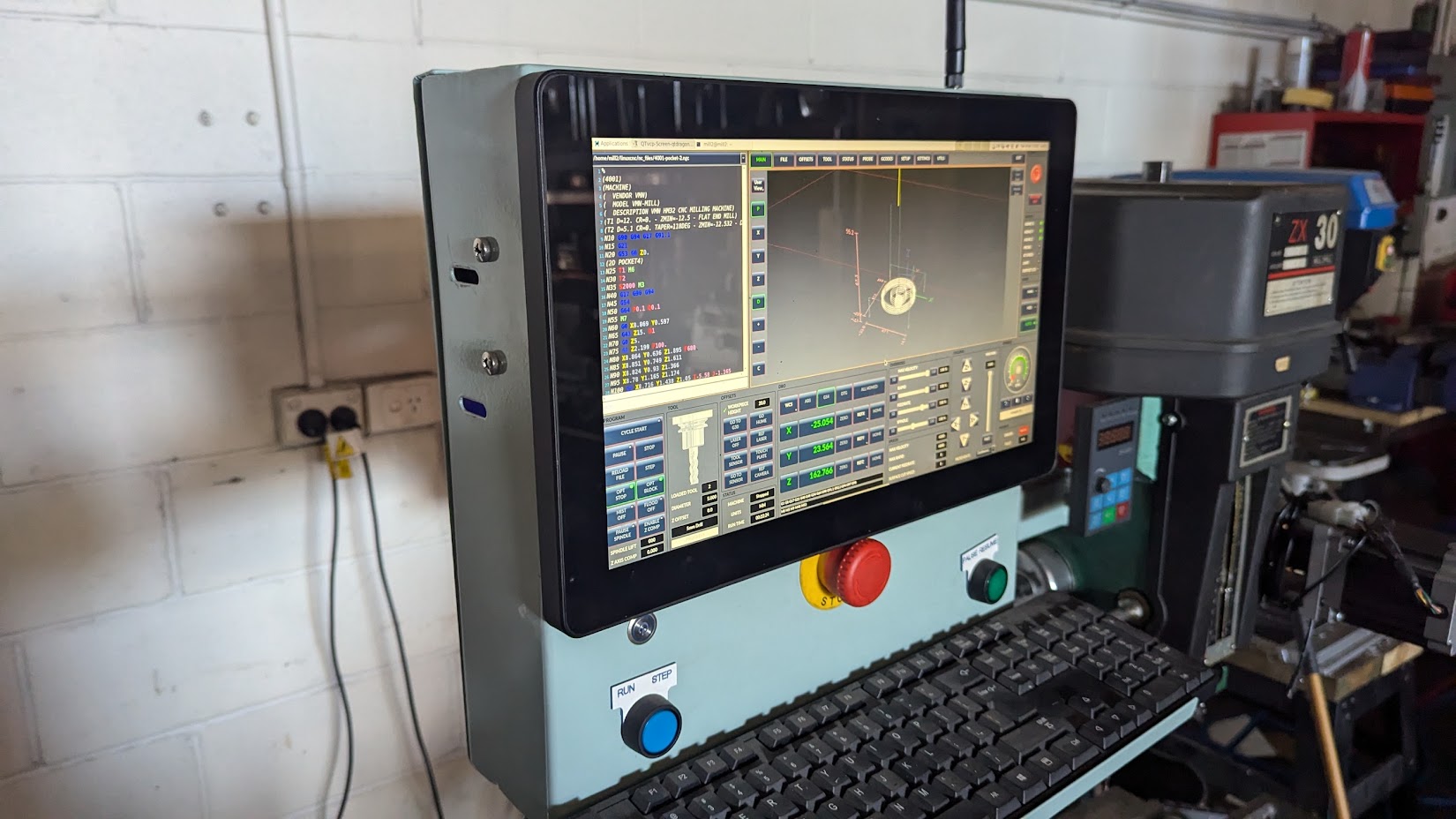

With the exception of the outer bezel their 15.6" panel mount looks exactly like mine. What have  you paid for one of these?
I had to get the wall mount version as I was squeezing it into an existing HMI enclosure that was too small to take one like yours. I looked back. 12 nobths ago, I paid USD $157 plus shipping to Australia so all up it was just under AUD $500
I needed 1080p for QTdragon and the existing monitor was only 1536 wide so nothing fitted the display.

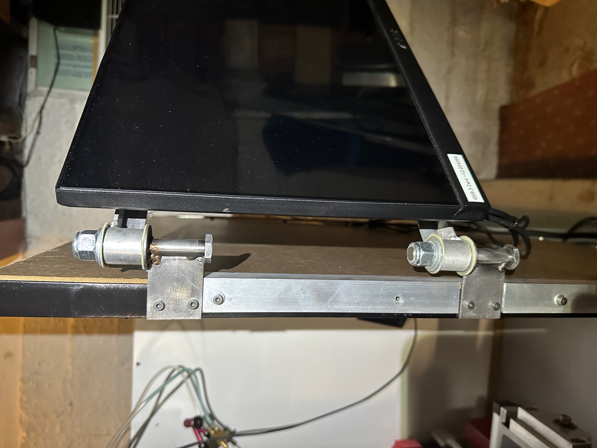

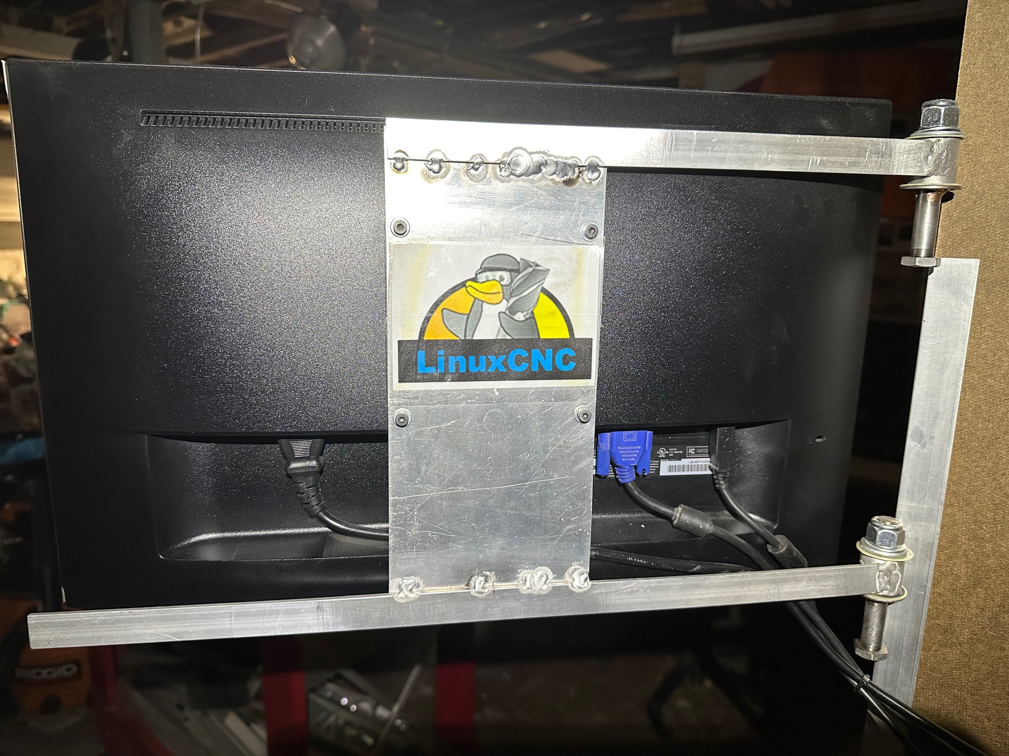

16 Jul 2024 19:18 #305387 by JohnnyCNC
Replied by JohnnyCNC on topic Touch Monitor Size - Any Consensus?
2019 is around the time I bought mine.
Below are some pictures of what I did to mount it.  I made a hinge with wavey and nylon washes so the hinge would have some friction and stay in place when I folded it out for use.
