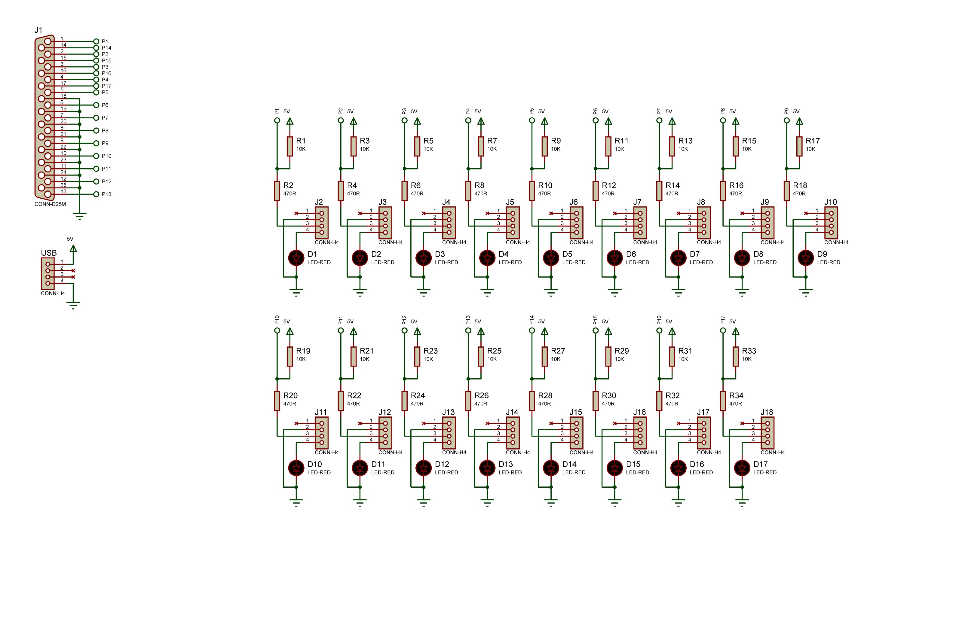

I wanted an easier way to test a new PCI parallel port card in all three modes (OUT, IN and X) in order to help with this topic here:
forum.linuxcnc.org/18-computer/54368-pci...-work-out-of-the-box

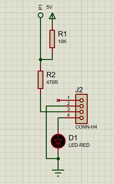

So I came up with this simple, yet "powerful", parallel port test board. The core circuit for each pin is very simple and uses only 4 components. No IC and no transistors required.
Every single pin can be tested as input and output. It is passive (no buffer) but I have also added a USB conector to provide 5 volts to 10k pull-up resistors (some cards won't have pull-up resistors for every pin). I used different color LEDs to represent each register: Red for Data, Green for Status and Yellow for Control. However I would suggest not to use yellow LEDs because they are not as bright as red and green ones.
It is handy to diagnose single damaged pins. Sometimes a given card has only one or two damaged pins and maybe they have got only input side damage (I have never seen this last case, but I believe it can happen). So you can swap pins positions knowing in advance what is still working.
(Btw, if parallel port masters here could suggest better values for resistors I'd be happy. Maybe 20k for pull-ups? I know some cards require more current to trigger control register pins when working in X mode, so maybe 490 ohms would be too high. But I also don't wan't to destroy non open-collector pins while investigating a unkkown card in X mode)

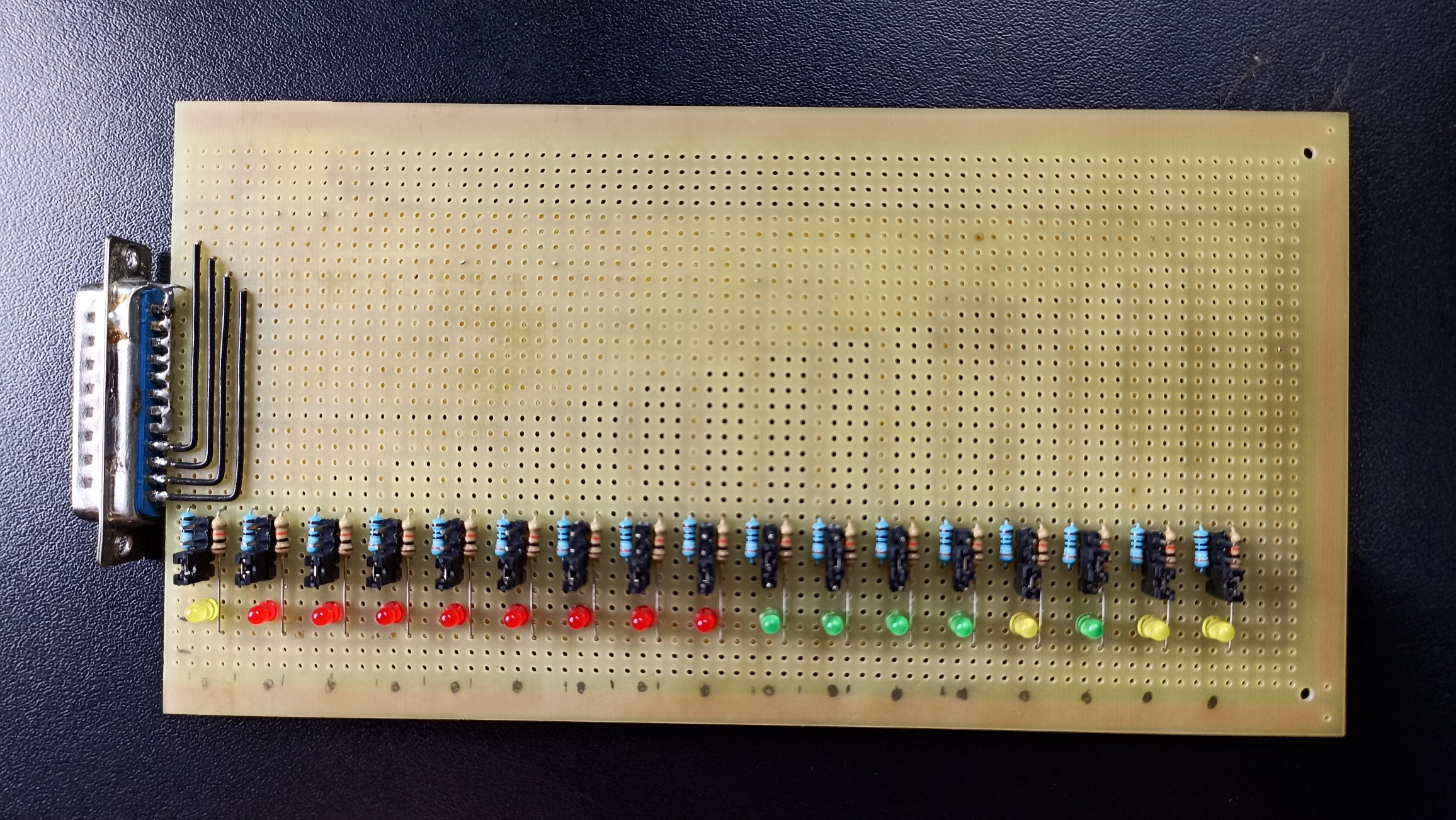

I didn't have any three position switches laying around, so I used four pin headers instead.
I will be making a single layer PCB version soon.
As it is:
The LOWER position sets pin as OUTPUT and the led will lightup if STATE = HIGH
The MIDDLE position sets pin as INPUT with STATE = LOW (0 volts through 490 ohms resistor)
The UPPER position sets pin as INPUT with STATE = HIGH (it is actually connected to nothing, so it will just let the 10k pull-up resistor do it's job)

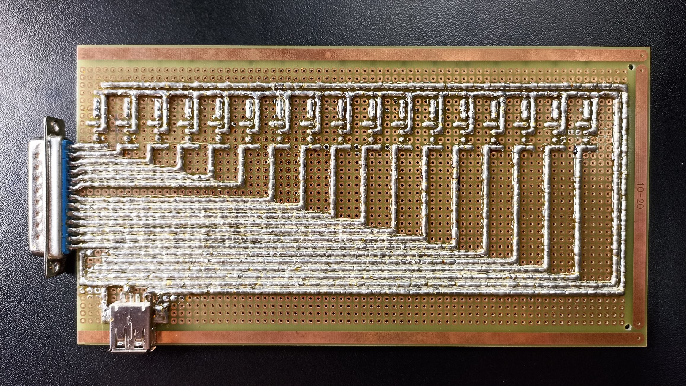

(I know, if one single atom of iron gets between this traces the will short circuit, but I had take as much time as possible to assemble it, so my wife wouldn't ask me to rearrange forniture... I also find it terapeutical to join blobs of solder, ONCE you learn the proper technique)
