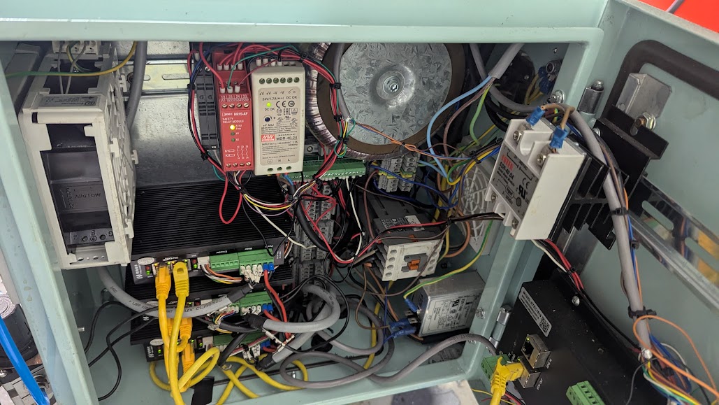

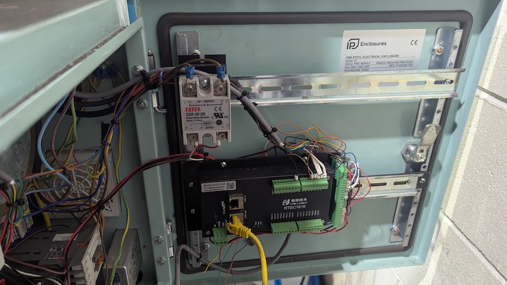

05 Apr 2025 11:06 #325753
Replied by rodw on topic 4-Gang 1-Way Switch To Control 3 Power Supplies and a Router Independently
This is what I am trying to get you to build.
This is Ethercat so there is no Mesa card
I have also used a safety relay but that will add $400 or more so get the estop wired right to avoid it
The power comes in at bottom right through an IEC connector with switch and EMI filter built in. We can't use this for your router as I wanted to keep it out of the filtered power.
Above that is the filtered power and above that are some Ocean Controls DIN tail terminals with the green earth one in the middle.
Above that is the round 60v AC toroids power supply for the stepper motors
Beside that is the 24 volt field power supply, red estop safety relay and a couple of slimline relays
At the right is a enclosure fan.
Below the 24v power supply is a tiny Mesa commx2 bus bar for field power. These are very cool.
and also a bunch of DIN rail terminals
On the door is a SSR the same as I suggested for you mounted to a DIN rail heat sink
And a Ethercat 16 input and 16 outputs module
Good luck!
Good luck!
