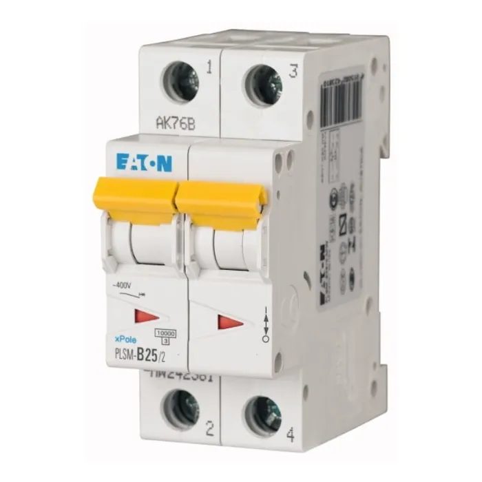

09 Apr 2025 07:51 #325970
by behai
Thank you tommylight,
I understand now. When I searched for "automatic fuses", I did get correct result, such as this one www.aurinkopaneelikauppa.fi/Automatic-Fu...30V-AC-slow-Type-C-2; but I confused them for circuit breakers.
Best regards,
...behai.
Replied by behai on topic 4-Gang 1-Way Switch To Control 3 Power Supplies and a Router Independently
It's a fuse and a switch in the same box, the picture shows 2 of them.
Best regards,
...behai.
