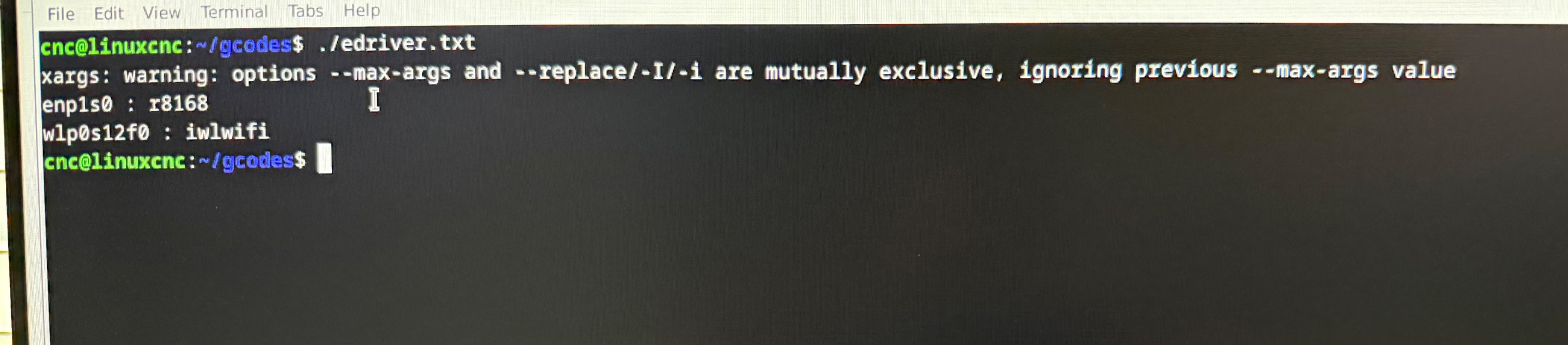

While searching in this forum, I found that some people had to install linux headers first. I did not do that.
When I run a script to identify the used drivers (JCW posted this somewhere a while ago), i get the followig result:
./edriver.txt
xargs: warning: options --max-args and --replace/-I/-i are mutually exclusive, ignoring previous --max-args value
enp1s0 : r8169
wlp0s12f0 : iwlwifi
Is this result "expected? Or did the driver installation not work?
Other people posted that they had to install linux-headers and purge the old driver...

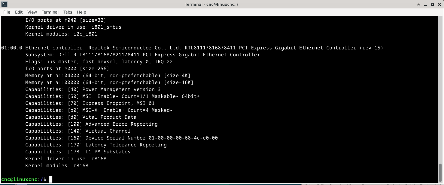

Thx Peter. Really appreciate your help. Last question …. Can you tell if my realtek nic is using the dkms driver or not? I attached the output of a script that you posted somewhere.Like I said in the first posting, I didn’t know that Linux headers might have been necessary when I installed dkms.
Last edit: 14 Jun 2025 20:07 by SebastianM.

14 Jun 2025 23:56 #330289
by DMNZ
Replied by DMNZ on topic Error finishing read... *sigh*

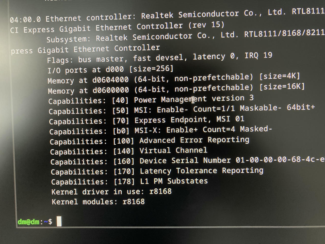

after installing the driver run this to check that it is the right one being used:
sudo lspci -v
under Realtek controller check Kernel driver in use, it should be r8168. (see attached screenshot)
to avoid problems i suggest to blacklist the r6169 driver completely in grub by adding: modprobe.blacklist=r8169
or, since your pc looks similar to mine you can add the whole my line to /etc/default/grub which through trial and error i found the most stable:
GRUB_CMDLINE_LINUX="irqaffinity=0-1 kthread_cpus=0-1 isolcpus=domain,managed_irq,2-3 rcu_nocb_poll pcie_aspm=off r8168.aspm=0 r8168.eee_enable=0 modprobe.blacklist=r8169,mei_txe"
don't worry it will not kill your pc it just rebalance your cores to do different things.
dont forget to run "sudo update-grub" to update grub configuration otherwise you won't see any changes after restart.
also check sudo dmesg for any errors during boot.

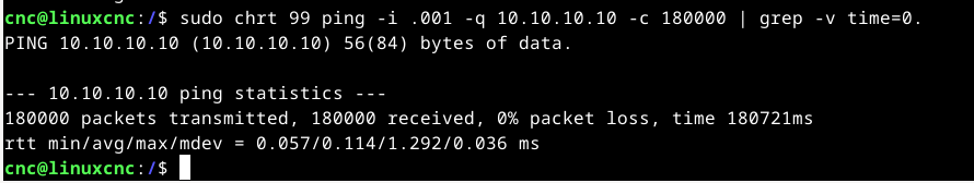

having 1.2ms ping once in a blue moon won't kill you. i suggest to add "grep -v time=0." to see how many actual pings you got over 1ms.
i normally run something like this:
sudo chrt 99 ping -i 0.001 -q 10.10.10.10 -c 1800000 | grep -v time=0.
this will run ping for 30 minutes with 1ms pings and only show you the pings that took longer then 0.999 ms.
if you see only one or two 1.2 ms in 30 minutes it is not a problem, 8ms is super bad though.
have fun!
sudo lspci -v

thank you, that is very helpful.
By running "sudo lspci -v", I could confirm that the right driver is used (see attachment).
But when I try to run the modified ping command, the result is just the same as before. It doesnt filter out any packets over 1ms... again, see screenshot.
I guess the command has to be modified a bit...

sorry, my bad, you should remove that -q in the command which makes your ping output quiet. try this:
sudo chrt 99 ping -i 0.001 10.10.10.10 -c 1800000 | grep -v time=0.
btw. are you still getting that error finishing read?
