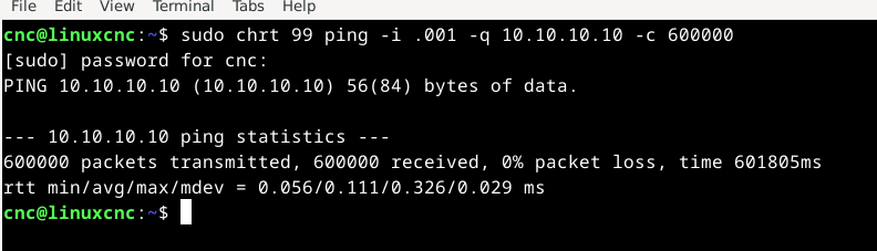

yip, very similar to what i am having on mine, interesting to see your latency histogram figures.
i still see occasional 1+ms packets once in a while mostly when I heavily use disk or usb which interrupt pci bus, or may be it is just noise and bad cable, but as i mentioned hm2_eth can work around it unless you get something over 3-4ms or 3-4 long packets in a row. then it will error out with can't finish read.
cheers!
cheers!

17 Jun 2025 00:54 #330370
by rickjmain
below is what my Grub file looks like, if there is something in here i can change, please let me know:
GRUB_CMDLINE_LINUX_DEFAULT="quiet isolcpus= 3 pcie.aspm=0 r8125.eee_enable=0 modprobe.blacklist=r8169 pcie_aspm=off idle=poll"
GRUB_CMDLINE_LINUX=""
These changes worked great by the way. I can't thank everyone enough. I went from 10ms max ping down to 0.105ms
Replied by rickjmain on topic Error finishing read... *sigh*
Did you get xfce to start automatically at boot again? If so what did you need to do?No idea if I did anything wrong, but after I applied that line from above and rebooted, Debian won’t launch the desktop environment anymore. I can manually start xfce. Never mind

- rickjmain
- Posts: 8
18 Jun 2025 01:21 #330430
by rickjmain
Thanks that worked for me as well, other than changing the driver to r8125
