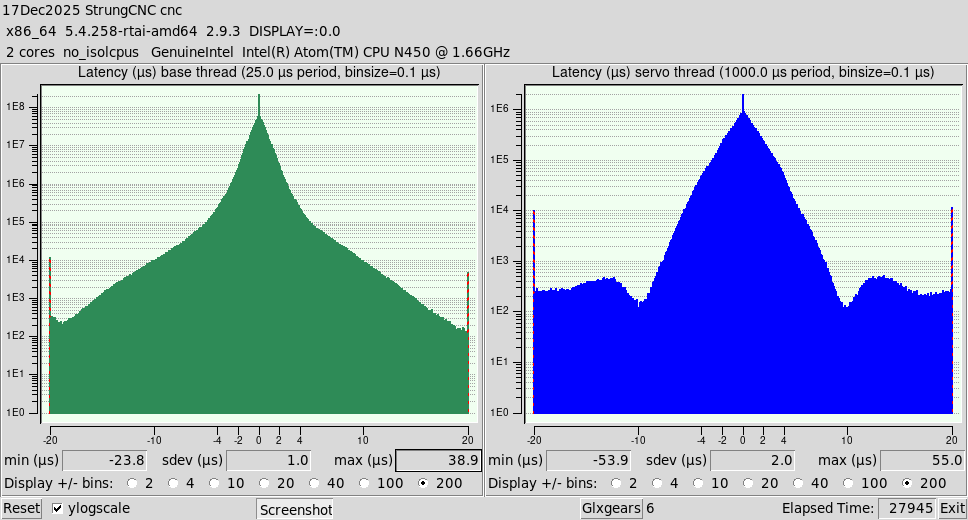

Last night i did clean install of Debian 12.12
And downloaded :
RTAI Kernel 5.4.258
RTAI modulesernel 5.4.258
LinuxCNC package for RTAI kernel 5.4.258
Now when installed the kernel the message with i915 did not show up.
After a night of latency-test the numbers are ok.
Hyper threading is active that why it say 2 cores.

Replied by Sekai on topic Advantech PCM 9362 freze when opening latency-test
I disable hyperthreading and now it show max 16us and it never froze.
Edit: btw i think i know why it froze.
I had a wifi card put in but now i remove it.
And the latency is better without it.

17 Dec 2025 01:50 #340234
by unknown
Replied by unknown on topic Advantech PCM 9362 freze when opening latency-test
Yeah wifi can be an issue sometimes.
It might be worth looking into some of the services that maybe running not is not required for a cnc machine, CUPS is one for example.

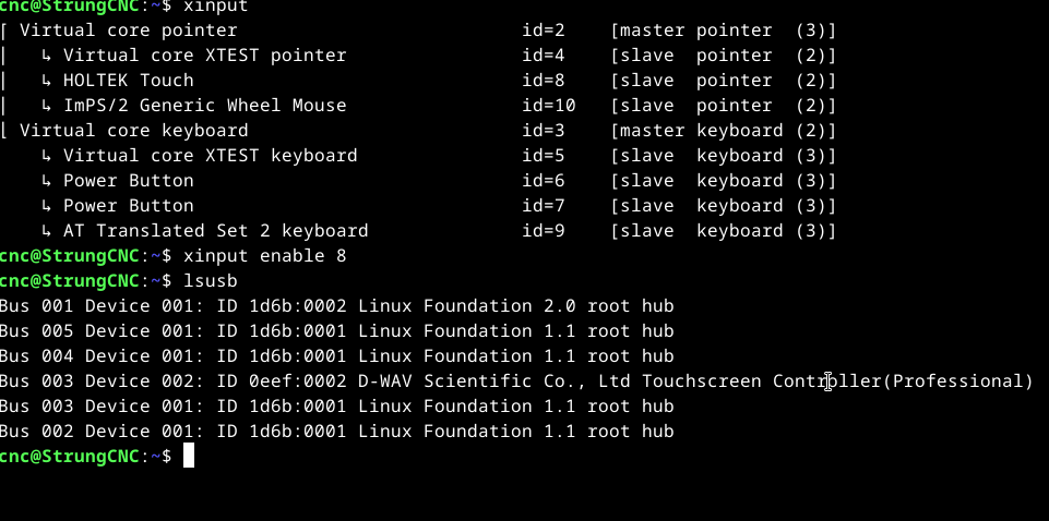

With this configuration i will leave like this.
The next issue is i have a 12 inch touchscreen monitor 1024x768 resolution but the touch does not work.
I have another 22 inch touchscreen monitor and it works perfect.
I verify the xinput list and it register the touchscreen as Holtek touch.
I tried to enable the touchscreen with xinput enable 8 (device 8 as the touchscreen) but nothing works.
